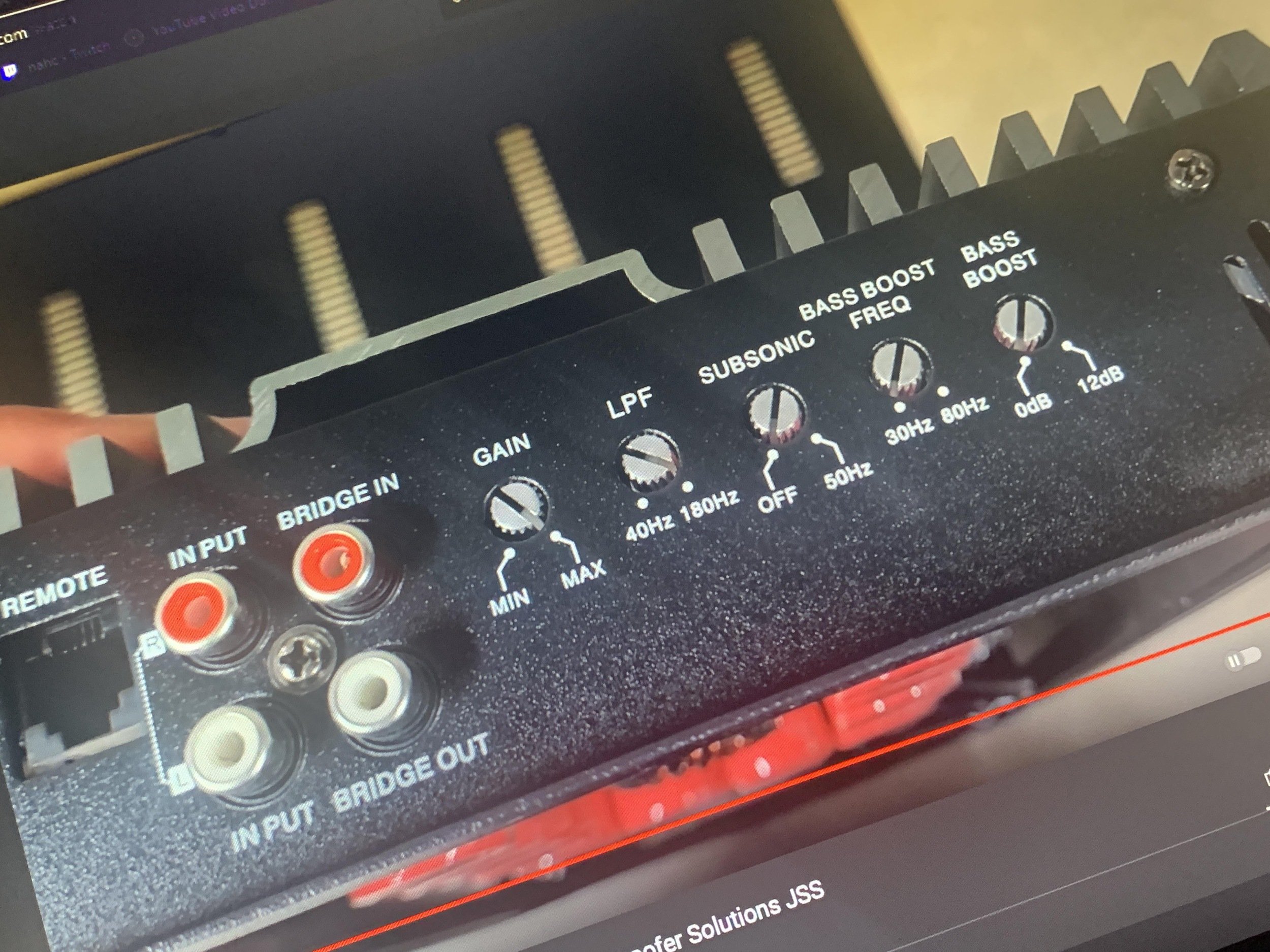

(Side of the AMP)
Holy **** thank you for all this information I really appreciate it!
1. When tuning i should only mess with those three knobs to the left and obv don’t touch the right two.
2. Let’s say it is pulling to much power that the alternator can handle. how could i limit it to let’s say 1000w or 1200w etc.
3. So you when i’m tuning it I should set the knob all the way then tune with the 3 on the left and just listen for good sound?
Thanks Again!!!
Yes. Keep bass boost off.
Yes you can lower the gain to lower power output.
I would set your gain properly and if your electrical can't handle then turn it down. Subsonic filter would depend on your box and port tuning frequency. LPF should be around 80hz.
Thanks Again!!!
(Side of the AMP)
Thanks Again!!!
No problem, that's what we're here for.
1. Yes, the low pass filter can typically be set around 80hz. Eyeball it and adjust to personal preference and blend with your front speakers. Subsonic is mainly to protect your subs from "unloading" below your tuning frequency. If you have a sealed box, I'd set it around 18-25hz, because the box itself will provide a bit of air "spring". If you have a ported box, you may set it just a bit higher depending on tuning.
2. Lowering the gain will limit the power your amp puts out with a given input signal voltage.
3. Turn your radio volume to just a bit higher than your normal listening volume to set gains. May be a good idea to use a multimeter to set gains until you get a feel for things.
