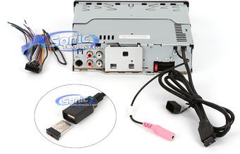

I have one last question, and it really has me baffled. According to Sonic Electronix, the back of my stereo headset looks like this:
What the HECK is that black and pink wire running next to the Bluetooth?? Is that the remote turn on wire? If so, how do I connect it to my kit's remote turn on wire that will run back to the amp?
I still don't know what the pink wire thingy is, but I'm pretty sure the remote turn on wire is in that large bungle of wires (far left in the upperhand corner). Is that correct?
Looks like a 3.5mm jack for an Auxiliary In. Why they have it on the back of the amp baffles me since I've seen them on the front for ages now. I'd look in the manual but am doing a bunch of other stuff ATM.
The remote wire is almost always in the wiring harness itself. What you're looking at on the right are just USB and Aux inputs. that wiring harness on the left should have the remote wire and is almost always blue or blue with a white stripe.
Gotcha. In the picture I posted earlier, zoom in on the wire on the FAR left, I see a blue wire with a white stripe running down the middle. Actually you probably can't see it, but it's there.
