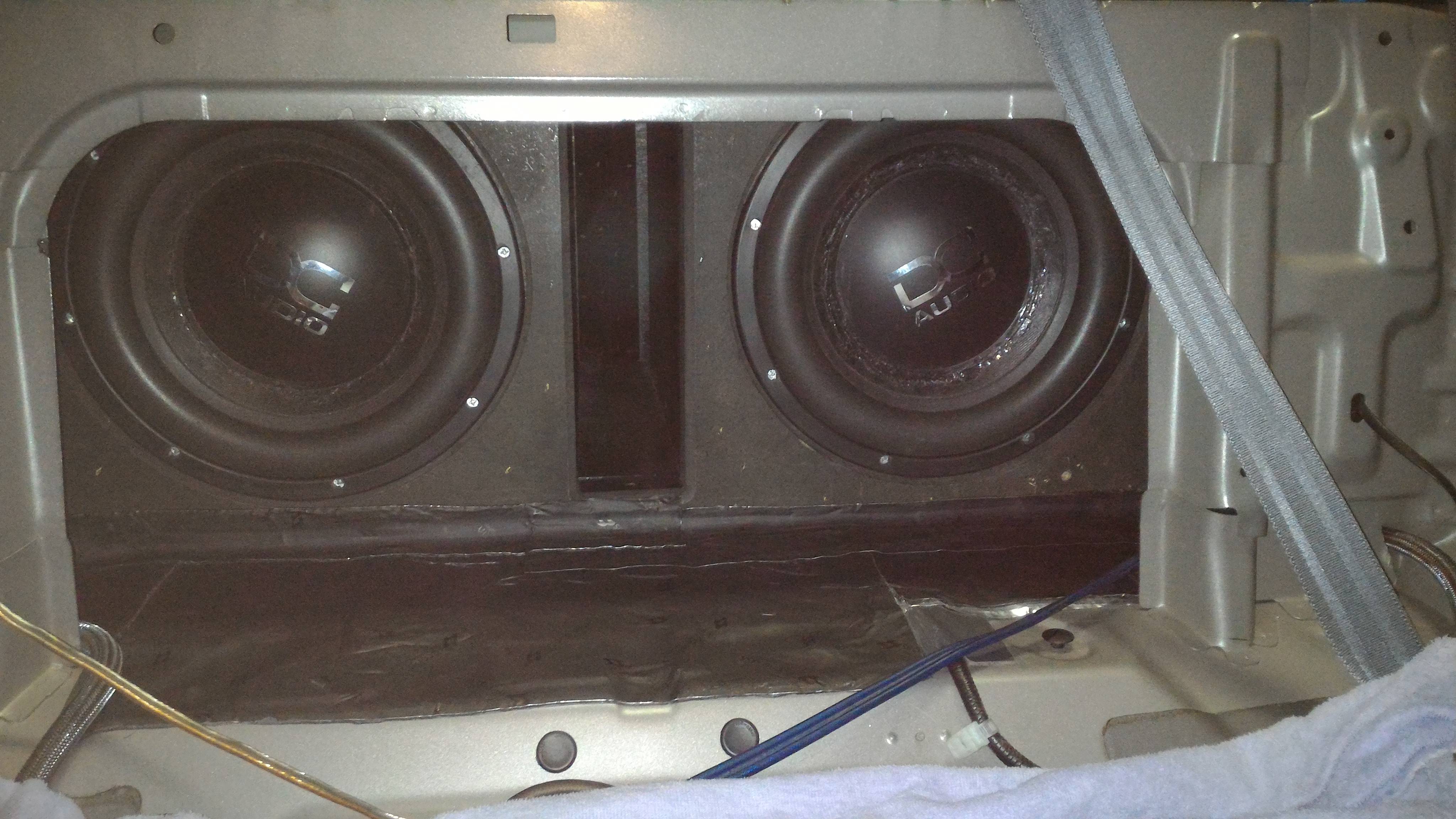

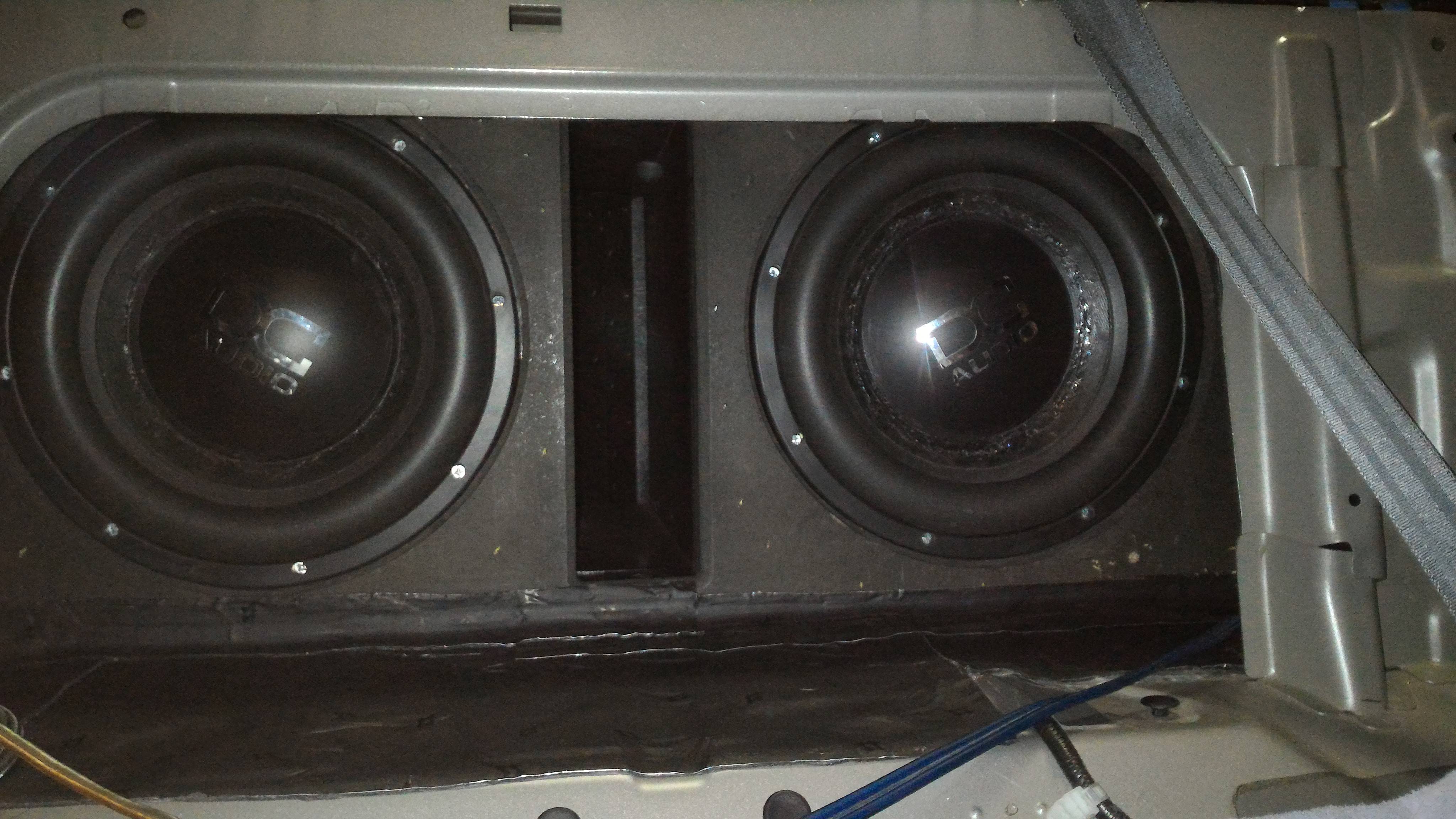

You could buy 2x 12" DC Audio XLM2's for that price point. But like these guys said, building a good box is key. These subs destroyed my old $200 prefab box and I had to get a new one built by Cody Johnson (DC Audio Rep at the time).

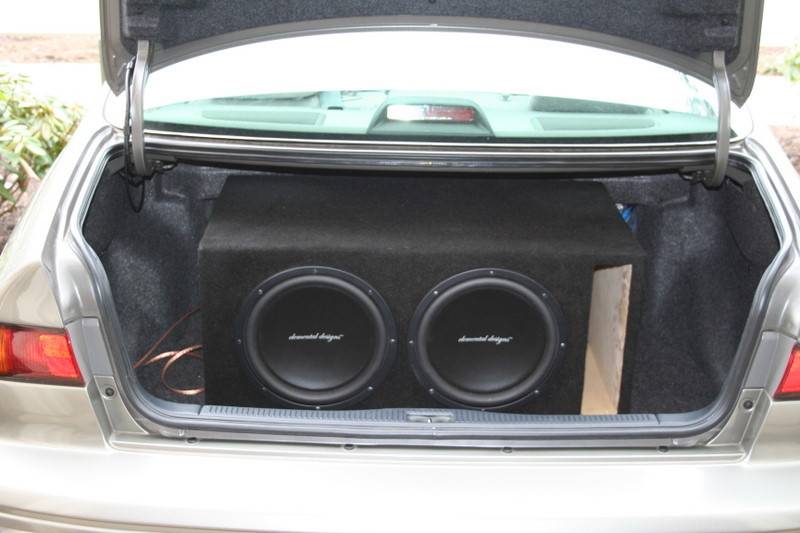

Did you spray paint your subs black? Also...never a good idea to put high power subs in a prefab.
@ Boomin_tahoe
Nah. The subs came with black dust caps. The dustcap of one of the subs I owned popped out twice during the 4-5 years I've owned them and I just reapplied Amazing Goop to put it back on. I had the guy who built my box paint the vent area and front and I was going to either paint the rest of the box or carpet it but I never got around to doing it. I originally had the subs facing the cabin and only needed the front to look nice but recently re-positioned it towards the rear for better SPL.
I figured this would look nicer too:

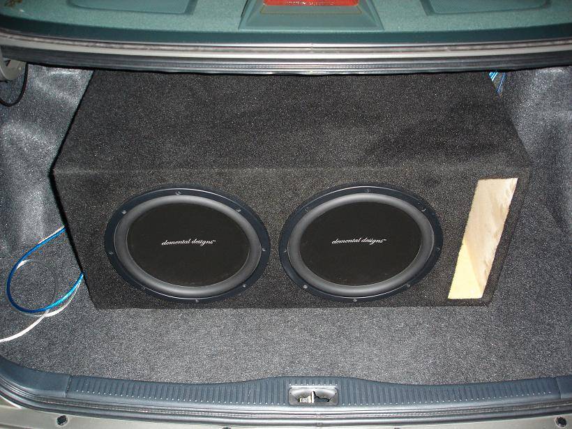

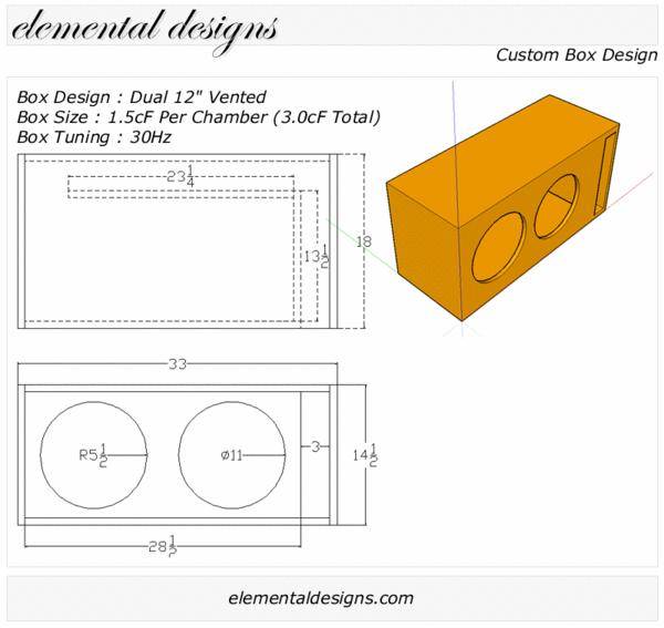

specs of my old prefab box (was my first system back in the day - 600 watts rms total for subs):

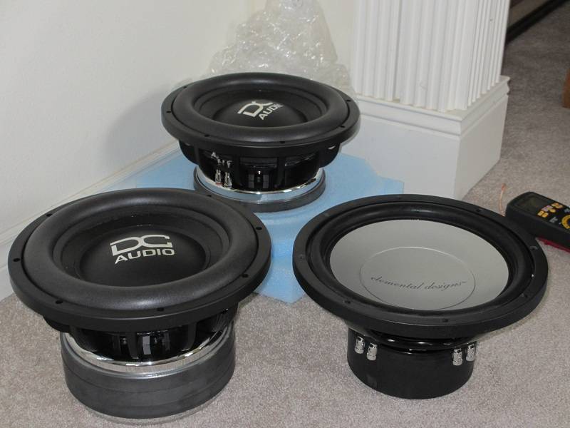

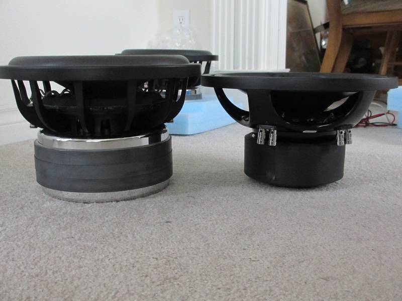

Here's a picture of what the XLM2's look like next to my old Elemental Designs subwoofer:

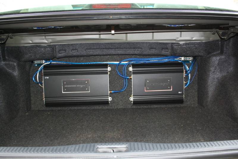

The only eD amp I still have is eD Nine.2 but I'm keeping it for sentimental value.
I've owned eD Nine.2x, eD NIne.1, and eD Nine.4 and eDi 6000's components.
I sold my eD NIne.1 for only 80$ cash and regret it. That thing produced well over 1200 watts rms at only around 12.5V or so which was awesome.
It's a darn shame what happened to Elemental Designs because they produced quality products. That's a nice surfboard eD Nine.5 :)
Buddy of mine has the same exact DC sub in his garage....heavy sonofabitch!
