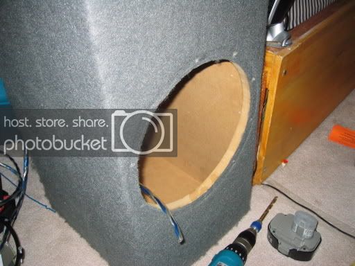

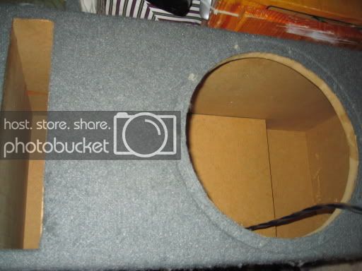

I had someone make this box for me for $150 back in October. Please
tell me if it looks like decent quality.

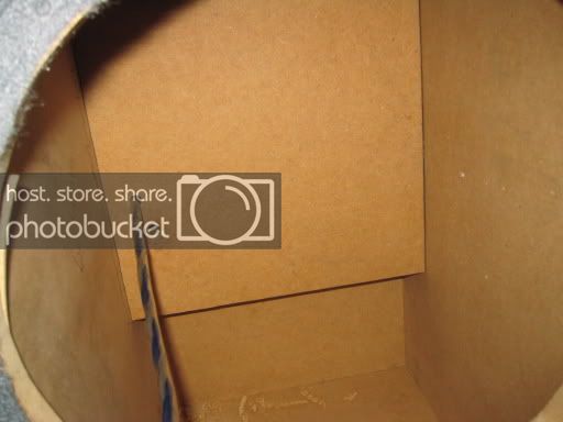

looks like they didnt caulk the inside like they should have. and who the hell drills through the port wall for wires? and no you dont put anything between the sub and the box when you mount it.

The guy had the the original hole drilled in ( you can see it empty now) and i called him up and asked and he said it just keeps the mess simplier. Anyways i agree the carpeting looks ugly, but either its the sub or me, but it dont sound so good. in my opinion. Yet the specs were followed as the JL specs.
WOW....... umm lets just say you could have done a lot better for that price.
lets just say you get what you pay for.......was it local or was it shipped?
150 shipped for that box isn't a bad price, and it's not horrible, but like spkrman said it has some flaws that could have been easily avoided.
