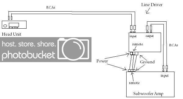

So I got a 4 volt head unit and I'm looking at installing a line driver. The phoenix gold tld22. I understand that you gotta have it right next to the head unit and all that blah blah. Now this will send a better signal to my amp. MB Quart 4125. Will the MB Quart pass the same signal on to another amp? MB Quart 200.1D. Also, what will I need to ground the line driver and how exactly do you do it? lol noob. Thanks guys.
haha this forum ***** sometimes. Line drivers are f&cking awesome, I just put one on my buddies car. OK you got a decent line driver too (had to look it up). Whoever told you to put it up by your head unit is kinda dumb. I mean you could put it up there, but its 1000X easier to put it right by the amp. I don't know if you know exactly what a line driver does, but in case you don't it interrupts the path of the rcas and instead of getting 4 volts, in your case, it will bump it up to 8 volts before clipping. So now to get to the point of your post. I would put it right next to your amp. Next you need to get it power so get some wire and plug some wire into the +12 (power) and connect it to the power in the amp, do the same for the remote and the ground. Now that it turns on you need sound. Take your original RCA that was going into that amp and plug it into the 'input' part of your line driver. Next take another set of RCA's, preferably short ones since the line driver is by your amp and plug one end of the RCAs into the output of the line driver and the other end of those RCAs into the input of your amp. Here I'll draw it out in a picture if you're confused. Hope I helped man.

It is supposed to technically be better closer to the head. Line drivers are supposed to be for long cable runs and are meant and designed to run the voltage through a longer than normal rca cable. So if you put it in the trunk, some will say that you are defeating the purpose of the line driver because it's too close to the amp. Most manuals will instruct you to install it as close to the head as possible.

Look at a planet audio line driver though. There is not way to put that close to the headunit. Its the size of a small amp
Get a smaller one. I don't think Planet put that much thought in their design. I like the Audiocontrol stuff. You could get an EQX and put it by the amp. I know it's an EQ, but it has up to a 9.5v output. It is a awesome azz piece. I don't know how I ever lived without it. I always told myself that I didn't need it, but boy was I wrong! It made my system play louder, cleaner, and made the bass hit harder and deeper. People always ask what kind of speakers I have, but I tell them the EQX is making them shine. I have 2 sets of the PPI 356cs and they just sounded ok at first. The EQX made them sound so good and they don't lack any midbass and the tweeters go crazy. My midbass can be heard over my 2 15's. Just keep in mind no built in head unit Eq can compete with an Audiocontrol Eq. I learned this the hard way. I usually get bored of comp sets pretty quick, but have no desire to upgrade from the PPI's. Some say AC is expensive, but they are totally worth it. The only thing they overprice is that remote control thingy for their digital eq's.
