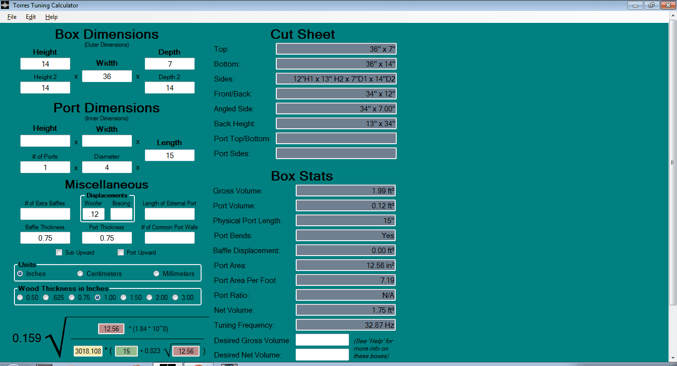

Here's a single 12" behind seat truck box ported... Torres makes it easy
