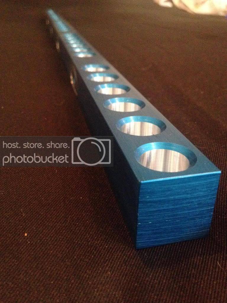

I have a CT Sounds 4000 and I have it powered by 2 yellow top optimas and the stock under hood battery. Im about to strap a second 4000 to it and move my two optimas under the hood. Ill be wiring three 15" mojo 5's to them at .66 ohms and I have a Singer 275amp alternator along with my stock 160amp delco. My question is how many batteries will I need in the back to support my amps and keep them in the high 13's on heavy bass notes ? I want to use the XP3000's with toolmaker buss bars. Any information would be appreciated.
