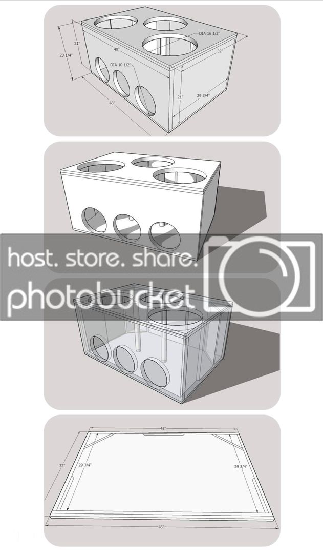

He was able to find his blue print sheet. He has no idea what’s it tuned to or anything, he just got the box built and they gave him to sets of aero port tubes one for competition and one for daily. His best meter was 147.2 with 2 18s and one of the holes covered since he blew the 3rd 18.
Here is what he sent me
48"W X 25-1/2"D X 20-1/4" H. Replace the port and top. Run a double baffle on the top. That starts you at 11.625 cubes in the box. I hope you know how to cut straight seal things up. You will have to figure out the port.
