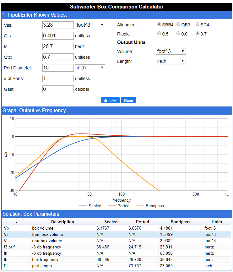

I just want to know if this would be worth my time and money or should I keep it simple with a sealed box?
Vehicle : 2012 Infinity G37 journey sedan
Location in the vehicle: Trunk directly behind rear seats (they don't fold down)
Space available (Length x Width x Height):
Subwoofer make and model: JL Audio 12W3-D6 old 2003 model
Subwoofer Size: 12"
Number of Subwoofers: I have 2 of the 12W3-D6's. The 3rd one was lost.
Type of Port (Kerfed, Slot, Aero, etc.): Port through rear dash maybe?
What type of music do you like?: Trance, house, dance, metal, classic rock & symphony compositions.
Is your goal SPL or Everyday Music?: 70% everyday music 30% SPL I'd like both if possible.
Tuning Freq (Hz): Not sure but I'm guessing 30-80hz total range? Someone educate me on this please.
Volume : Attached calculations I got from an online calculator. :/
Questions: It would be a tight fit for both 12" subs I know it's a small trunk but I would be happy with one if that's all I can fit.
