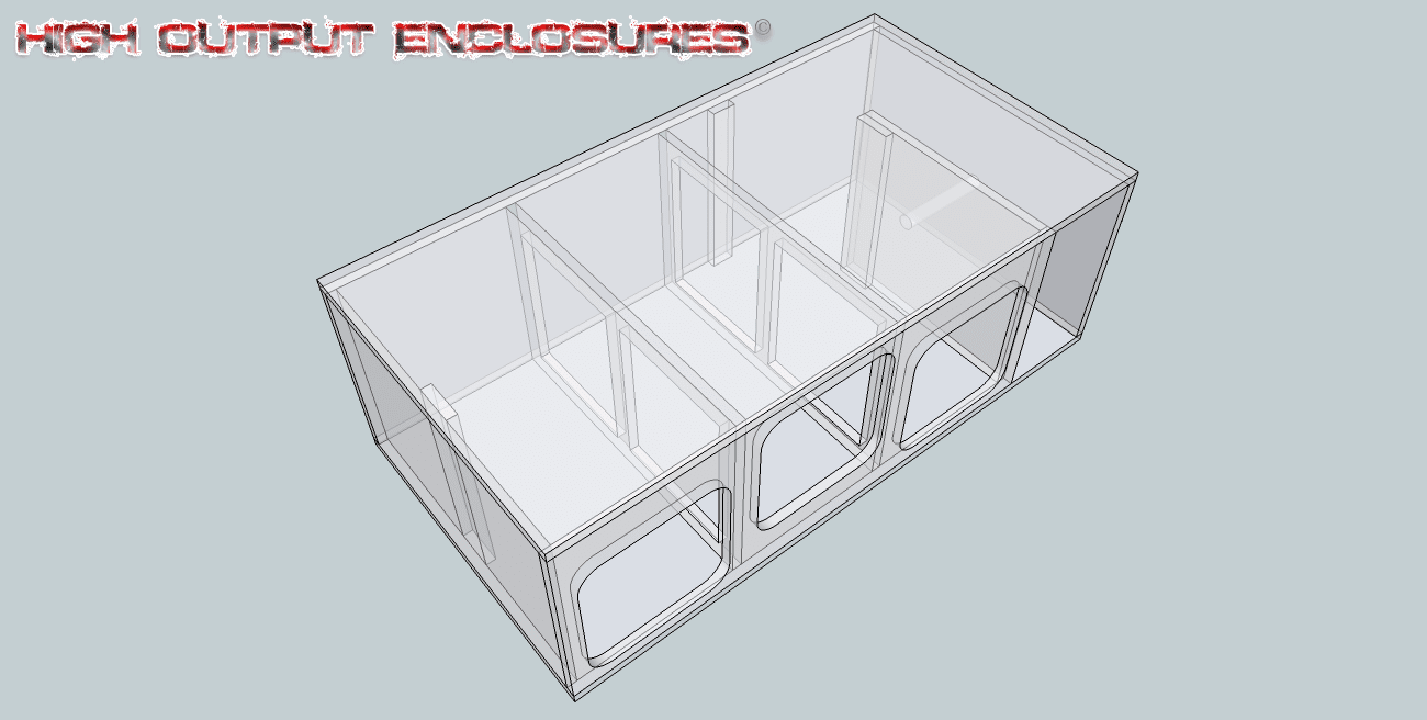

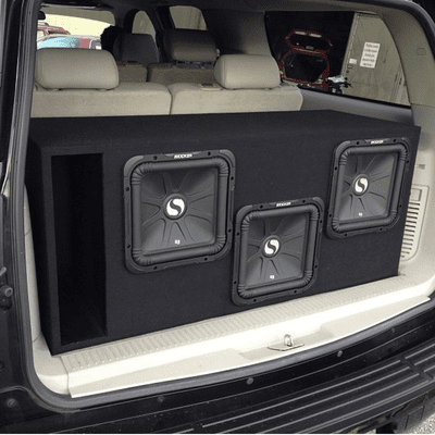

A few of my L7 designs
We built and installed this one. I'll never forget this, I was 21 when I designed this box. The dude who we built it for, came back after the subs broke in some and we turned his amp up to full power. He got there, saw me hanging out, and he said to the shop owner, "That guy knows what he's doing." 😂 :geek:
Some people have never heard a proper sub box before, and they are surprised at what their woofers can do.
It's 3 L3 12's in like 2.25 per sub or so, did this 8 years ago:
28918
28917

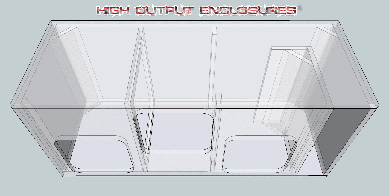

Another 3 L7 12's:
28915

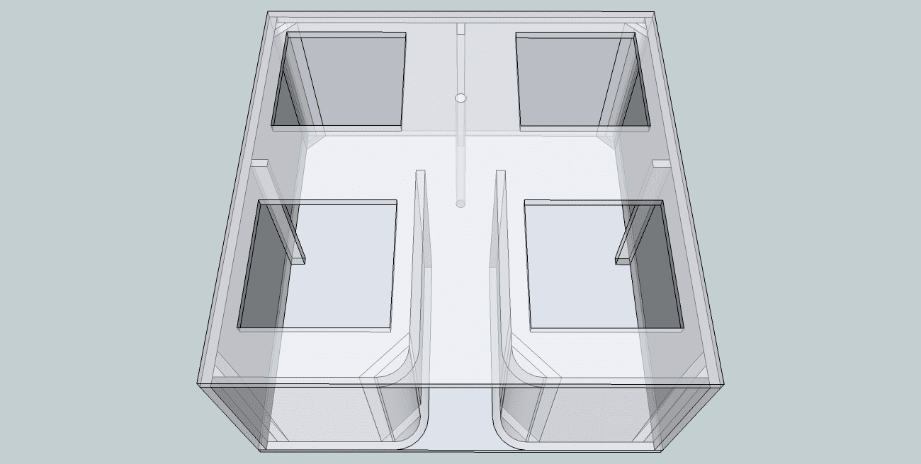

4 L7 12's:
28916

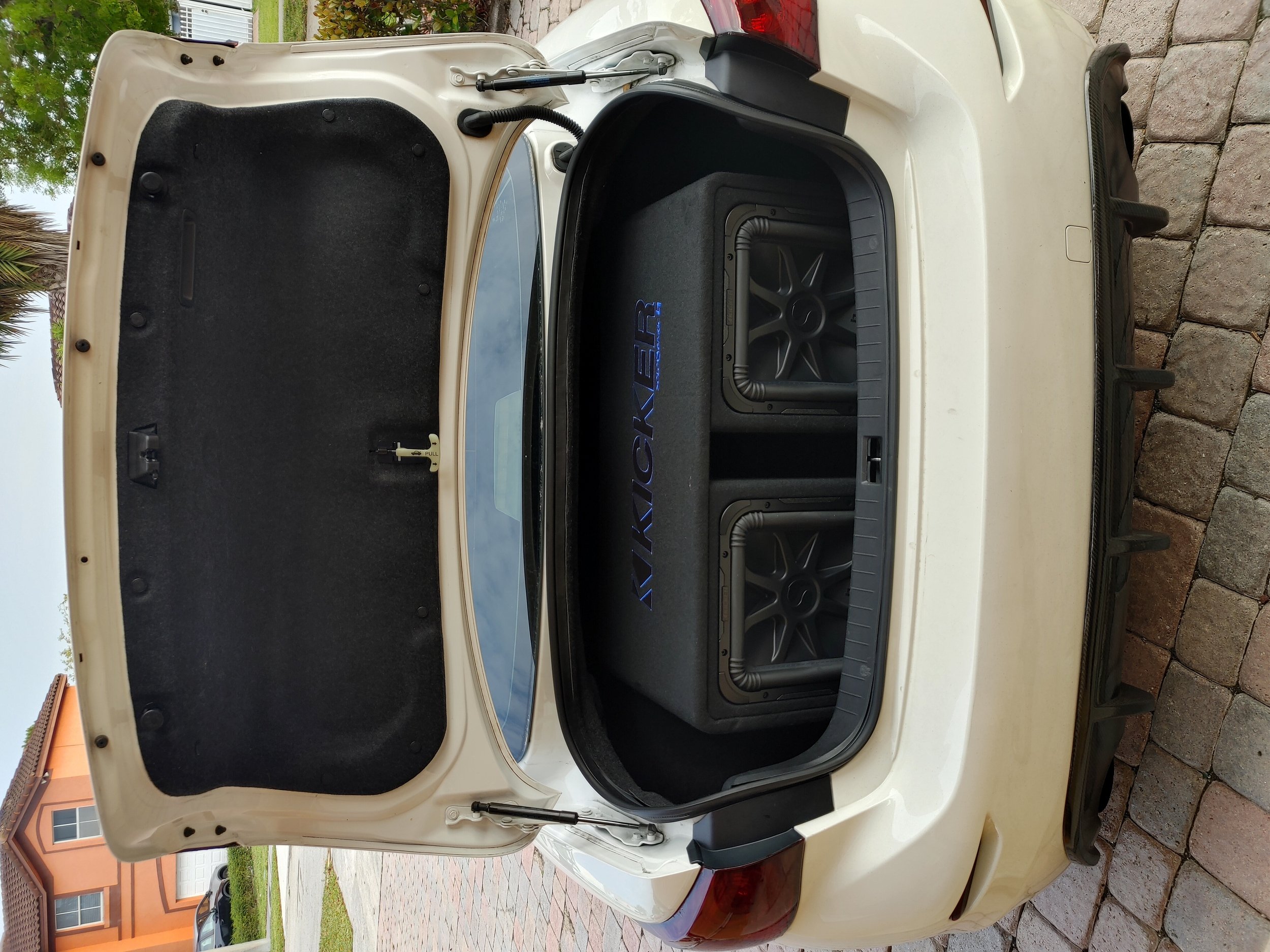

Hey thanks for your input, it's a factory kicker box tuned to 25hz and the measurements are 33-3/4"W x 16"H x 19-1/2". Are you saying I should try facing the port towards the cabin? Also how long do you think I can run it at peak power without blowing them? I'm sure the ratings for these subs are on point.

That's what Crutchfield said lol, but I cannot go any bigger it takes up literally every inch of space in my trunk with a 3 inch headroom from the port to the trunk lid. I don't know what's wrong. It just doesn't hit right till I give it more power.

The box is 33-3/4"W x 16"H x 19-1/2" and it's loaded. It's huge and weighs a ton. This is the link to the subs and box.
https://www.kicker.com/solo-baric-l7s-loaded-enclosures
If each side is .75" thick, that's 4.4 cubes or so internally (with the wedge), hard to tell how it's layered together. So I'd say you're even less than 4 cubes net, probably like 3.5. I think the minimum box size is 1.75 cubes, and 25 hz port will be long, but it is a slightly smaller port area, still gonna take up room being at 25 hz, if that's true. So that small box size is limiting the cone travel of the L7's, IMO.
That box is probably minimal for everything, and that's why it makes minimal sound. You can do whatever you want, your box isn't gonna be good unless you change it. You can waste money buying amps and whatever, or you could just make a proper enclosure or fit subs that will work in a proper enclosure.
I hate to break it to people like that, prefabs are usually a rip off. I've heard some very loud Kicker prefabs, but they are literally the bare minimum of what that woofer needs, and that's why you're having the problems that you are. Those subs need like 50% more airspace than they have.
