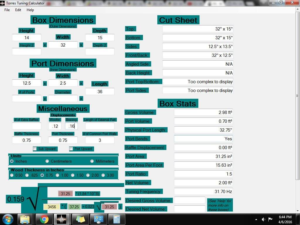

How did you get that tuned to 32hz? On torres Its not showing that thats even possible with that port size? idk maybe I just do not know how to properly use the program
Never used torres. I have to very carefully use RE's box calculator. I set my height and depth so I keep the same port area and adjust the width to find the numbers I need for a given net air space. The enlarge the actual enclosure to offset the displacement of what I reduced in the calculator.
Thsi comes up identical to RE. Keep in mind that you can't just plug numbers into RE's Box Calc and get correct tuning.

By adding in more space to make up for the port changes your tuning bud. According to torres you would be at 35.98hz
You're misunderstanding me. I build the box on RE to the net volume (it doesn't calc sub and bracing displacement). Say I plug in a size that gives me a net volume of 2 cubes with 30 sq inches of port and a port length of 30 inches. I then figure up my sub and bracing displacement and add width to the box to offset the difference. Thus keeping my net volume at 2 cubes and port tuning accurate.

those arent accurate as torres because they dont account for the space the port takes up and that obviously changes tuning by a lot and you are at much less airspace then 2 cubes. Along with common port walls etc.. You'll have to do a lot of your own calculations
Vs torres where everything is already factored in.

your port area is a lil low, overall box size is small as well. put 3 in common port walls since its a regular L slot port.
1.63 ft^3 before all the bracing and extra displacement from the corner/round over
I'm sorry but you're incorrect. Not counting the area inside the box at the end of the port I'm 2.02 cubic feet.
The large part of the inside chamber is 27.25x12.5x10.5. Even if I remove the end correction factor from the enclosure I'm just under 2.2 before sub and 45s.
View attachment 26554684This is what I got but like I said not sure if I am using torres right.. But thats why I am here //content.invisioncic.com/y282845/emoticons/biggrin.gif.d71a5d36fcbab170f2364c9f2e3946cb.gif
I'm not sure as I've never used Torres but I'm doing pencil and paper math using the physical measurements of the inside of the box and it lines up perfectly with what any port calculator tells me. So I can't help with using Torres but I wanted to share what I did recently since dimensionally it fit nicely where you have space.
I'm sorry but both of you are incorrect. Not counting the area inside the box at the end of the port I'm 2.02 cubic feet.
nope he just doesnt know how to use the program properly. As said, most noobs dont know all the proper displacement calculations needed hence other online calculators such as RE, 12 volt or the one you used that require actual pen and paper knowledge will leave them hanging. All the calculations you did can be summed up and finished within 30 seconds to a minute tops with torres starting from scratch with just max dimensions. I've come from pen and paper too, torres and xplicit audio's calculator is the way to go nowadays.
