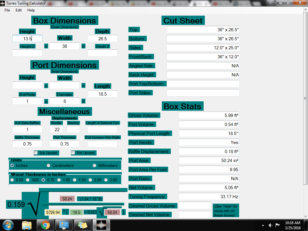

I want to build my own box. Never built one. But here it goes. Have 2 sq hds12's powered by a ED nine 1 in dodge avenger. Max specs for trunk are 36w 14.25 h and depth is negotiable up to around 45. All outer measurements. Ported. All i listen to is rap. I want to feel the bass. Current box from prev subs is h 14.25 w 35.5 d 17.25 all outer measurements.. And to be honest it doesnt have the deep feeling bass im looking for.. Any imput is appreciated

Follow this design just like it says. Attach the port in the center between the subs. You basically just make a square box, cut 3 holes, two for subs one for port and glue on the port to the box. Try with low tuning first and start chopping the port shorter inch by inch until you get the sound you want. Use threaded rods or wooden dowels to brace the box. when it says number of extra baffles 1, it means have an extra front side cut and glue them together so it can support the subs properly. Use Birch ply or 7 layer or higher plywood. MDF will be heavy.
Buy this Take a tape measure and try to get as close as you can to 8 inches in inner diameter because they all vary in size.

Would i be better to use pvc? That way flared would be possible.

With an 8 inch diameter port, You have plenty of port area to never see port noise. Flare is needed when you have low amounts of port area which is causing port noise. Aka if you used a 6 inch port instead of 8 is when you'd want the flare. Plus 8 inch pvc is a lot more expensive than sonotubes.

Ya i looked and im not payin that much for plastic lol. If u say it'll work ill trust u. Been playin around with torres. Would i b ok to increase the height just a little for sturdiness

Sure go ahead, your tuning will be lowered a bit with the airspace increase
