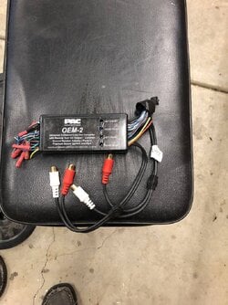

Will this work?

Idk if that will help... you got a 2V HU correct?
I've ran into amps that like big signal before... just sayin'
I took the splice out and ran one of the cables direct. Boom, it hits good.  However, I do notice some of the lower bass lines in songs not picking up.
Ya adding any other connectors, splitters, converting adapters to signal send will always reduce the original signal being sent in some way.  Plust if you are only using one of the jacks (mono) then you are basically splitting that in half to begin with. Any other settings on the Deck or amp off? Crossover?
