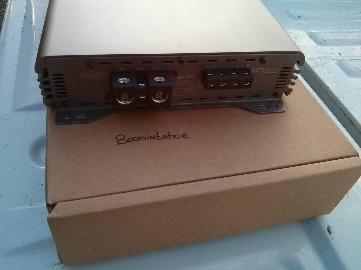

IF it was a true 3k amp and had 1/0 inputs, you shouldn't have a problem. (Pictured is my 3k amp with those 1/0 inputs)  What you said above the amp has 4 gauge inputs must be a cheapo amp then. As already mentioned earlier, get some 4 gauge to 1/0 gauge reducers.
