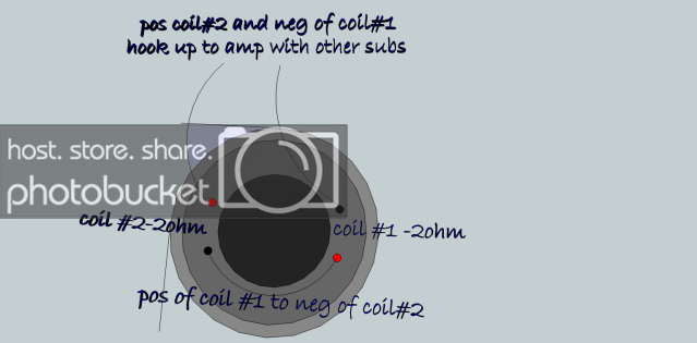

M matt.pitts Junior Member 2 0 newfoundland Mar 6, 2012 #1 i have a alpine m2000 amp and 3 alpine type r 10 2ohms subs and i need a wire guide to hook them up can anyone give me a hand Click to read more...

dappa5 10+ year member DO WORK! (if u can) 1,858 0 S.W.FL Mar 6, 2012 #2 are they svc 2ohm or dvc 2ohm? n/m i see the only come dvc ......so u got 2Ω+2Ω
dappa5 10+ year member DO WORK! (if u can) 1,858 0 S.W.FL Mar 6, 2012 #3 ok so for three you are gonna series the subs and then parallel them together @ amp so subs will be @ a 1.33 final load // now that amp is a 2hm stable amp it may or may not run @ 1.33 the safer solution will be to run just 2 subs then you have the third as a spare either of those options will be wired like this remember if you run just two subs you will need to baby the gain cuz it is rated for 2k @2ohm
