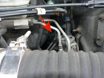

How hard is it to drill through the firewall though? Only other thing I see is a couple of wiring harnesses it has a little bit of rubber around them but connection itself is plastic.
There should be one behind the brake booster

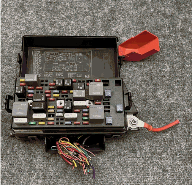

OK. You may find a fuse block under the rear seat cushion that you can tap into. My 99 Park Ave had one there. My Caddy does too, and attaching a lug to the feed terminal is simple:
