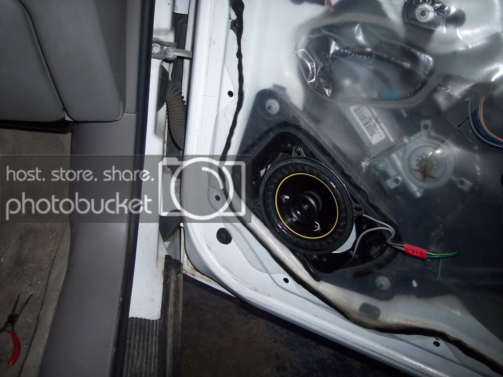

How do I deaden a door that looks like this....
This is the third time this week you've gotten this forum confused with chat roulette. Im just glad we caught you before you got your pants off this time.
I thought this was gunna be an easy install too. Is there any links, videos, or tutorials on how to build the door up? I'm more of a visual type person.
Here's a picture of another malibu that went with 5 1/4". I am going this route except I'm making my baffle and adapter plate out of one piece of MDF. Should I deaden around it...possibly seal around the baffle?
If at all possible I wouldn't use MDF. As wide open as those doors look, there is probably going to be some moisture in there. your 3/4" mdf will be about 1.25-1.5" thick in a month. Birch works well, I have been on a hdpe baffle kick lately. It's a little hard to cut, but it will outlast the car //content.invisioncic.com/y282845/emoticons/smile.gif.1ebc41e1811405b213edfc4622c41e27.gif
