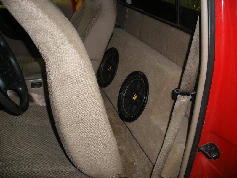

i agree you want to avoid mixing sub types and brands. but if you were dead set on it, i recommend separate sealed chambers for each sub.
this amp would give you the flexibility to run either 2 or 3 subs (and it's in stock)
Precision Power PPI BA2600.1D 2600W Class D Car Amplifier
how it will sound (2 or 3) is highly dependent on how you build the box and how it is sized. getting adequate airspace is important and you'd rather have 2 subs with proper airspace than 3 subs with too little airspace.
have you measured your maximum top and bottom depth, height, and width to calculate what available airspace you have?
something like this
http://www.netaudiowf.com/store/ford-ranger-ford/1999-2011-ford-ranger-standard-cab-sub-box-full/
the same way.
having a piece of wood btw them doesn't change how they'd be wired.
Whether you connect your wires directly to the sub or through a terminal cup -- the subs are still 4 ohms and you still need to connect them parallel to get 2.
