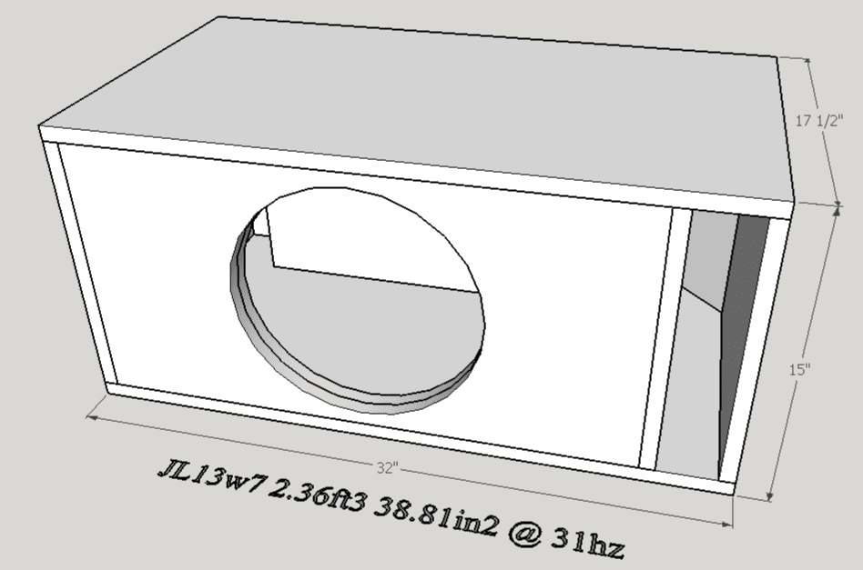

Again, go ported if space allows for immediate gains. Maximize the gains by getting a custom design or have a knowledgeable builder involved. Its going to be more involved than buying a ported box off the internet. Getting your enclosure done or designed (I love diy) is totally worth it as the thing will be oriented towards your personal goals. Bass takes space and comparing sealed to ported is about as comparable as the physical size... here's an example.
Totally worth it to have it done right. Extension into the low 20s with that JL 40hz signature punch. On top of low delay and hi output. Its a great sub but too many just nuthug the sealed enclosures as most "esoteric" drivers have always been traditionally sealed to achieve sq results but most will feel a lack of output and try to throw power at that JL coil which is notoriously prone to failure when clipped.
