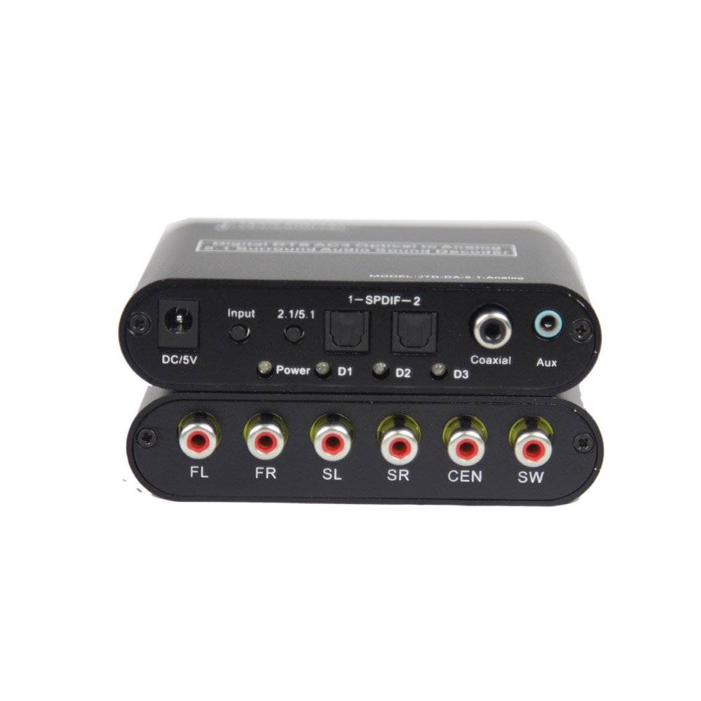

wire these 6 analog outputs into the input of a process
Talked to a few company RF, Rainbow. there techs inform me this type of method should work, the rainbow 1.8 has navigation inputs, and the RF .3 will allow descrete passthrough of a channel so i can basicly pass that low level navigation signal to the processor to be passed through with high levels into the channel of the amp i on the SQ4070. the germans seem far more helpful americans just wont answer a quesiton they don't know...or aren't 100 % sure. idk why. I do not know of any other units that decode cant find anything car grade. these looks cheap. i dont like the idea of them being he back bone of my stereo and being so cheap. so I'm headging. ideas? anybody know anything?

So something like an spdif to 2 channel stereo converter would be simple enough?
Rears may be pointless to you but not to everyone. I ride with allots people. Road trips. This cars audio build is built to from my experience and what i want.
Now the reason your not understanding I want the 5.1 decoded is I'm told allot of processors don't do centers well with rears so I was told by a member on a forum it'd be adventitious to use the canter channel in much the same way I plan to do the navigation feed.
