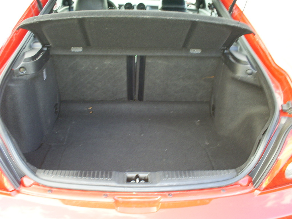

Daily. My space is shaped kind of like the box in your sign, moble. The hatch is maybe like 48" at the back so if the ports aim into there then I could have the full 24" front to back. Really want use round ports.
Can you show a pic of the area? Take a pic and post it? If it is daily, then placement may not be as much of a concern to you, but if it is, it may be recommended to have one of us design it for you. I just want to make sure you get what you want. But even from the details, I cannot put a picture in my head yet, I apologize. So, a posted pic of the space and idea visually will help a lot, if possible.
Not mine but same car, to think about it I could probably go a maybe another two inchs in height on the box if I take out the little board thing across the top and just get some tint.

Looking at the layout, I believe 2 12s may be a better option, or even 2 10s. I can do wonders with 2 10s for you if your interested. Personally, instead of worrying about choosing either a single 18 or 2 smaller drivers, why not calculate for both? You could see which gives you more of what you are looking for in a response and output. Generally, I like to use smaller drivers, as size does not determine output, when you are limited to a certain space. SO, now that I see the area, I would personally recommend dual 10s in a common chamber-this comes from years of experience in acoustics.
