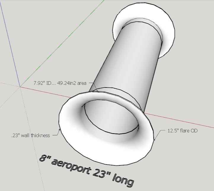

*backs up*...ok man just asking. But...what I really meant was the actual radius shape in Sketchup over the port.
Oh... you mean one of these?... PITA for sure... I suppose if I practiced enough... IDK
