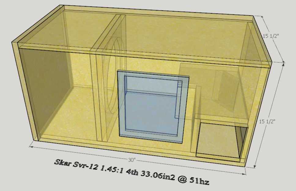

A guy in your similar situation contacted me awhile ago describing basically what sounds like the same issue to me. Its sounds like you're after punchier, accurate bass with some good lows. A nice musical all-arounder.
I felt a 4th was the way to go so I drew one up and he's very happy with the result. Punchier with good lows and without using a TON of space.
Personally I'd lean towards something like this...

I reiterate my recommendations. That Skar "low budget" sub will peak low, be boomy and have tons of delay low tuned in the 30's especially in 2ft3 net. I modeled it up in several enclosures as I have exp with this exact sub and a little exp to draw on.
I advised a box that will not lose overall output, be punchy and peak where he probably wants it vs a sealed disaster that affects power handling and has a HUGE peak coinciding with cabin acoustics leaving him in cheap azz sub/poor enclosure limbo like seems to be the norm anymore. Hey... Lets recommend an upgrade or just flame the manufacturer once again instead of trying to work with his equipment. Could be Skar, signal... frontstage... jeez... ok. Read into the T/S parameters maybe model it and see for yourself. A 4th would be my choice. Low delay, peaking in the mid 40's, a sealed rolloff with a ratio chosen to blend and have musical lows.
I do sub enclosure designs, not chime in just to type.
He mentioned a Kicker prefab as a good target, I took that as no extreme lows, low delay and punchiness to be the target... a musical enclosure.

And a properly designed ported enclosure is more accurate and has an output benefit out the gate, in this case a higher order enclosure is in order.
