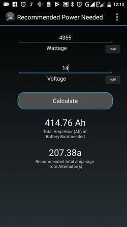

So correct me if I'm wrong but here's my conclusion:
The demand from my vehicle's electrical system with everything running is 1355w not that everything will be running at once and the demand of my amp is 2500wrms but adding a buffer of 500w for safety totalling 4355w. With the information I get from my ultimate car audio app pictured I am thinking I need a 250a alternator, 1 150ah lead acid battery for starting and 2 deep cycle batteries @150ah. Is there anything I'm missing?
