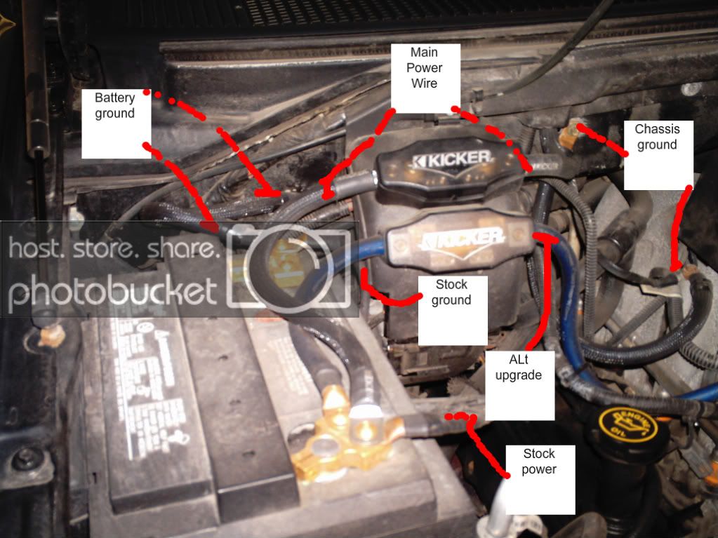

but u will need enough to do..
Alt to Batt
Batt Ground
Chassis Ground
Her is mines

did u not read my post at all? and get about 10ft, 15ft if its in a truck. better extra wire than too short. and remember dont take out the stock wire. run it along with it.
Well he could remove stock wire but its just unnecessary work.
ah i read on here somewhere that its best to keep it because the big 3 wiring is just to get more power and will add to the stock. oh well. its neither right nor wrong //content.invisioncic.com/y282845/emoticons/tongue.gif.6130eb82179565f6db8d26d6001dcd24.gif
yep.... every every bit helps cause they say power only flows on i think 2/3 of the wire. Like in My case i could have removed it cause it was all in the way i just decided to Mod the stock.
