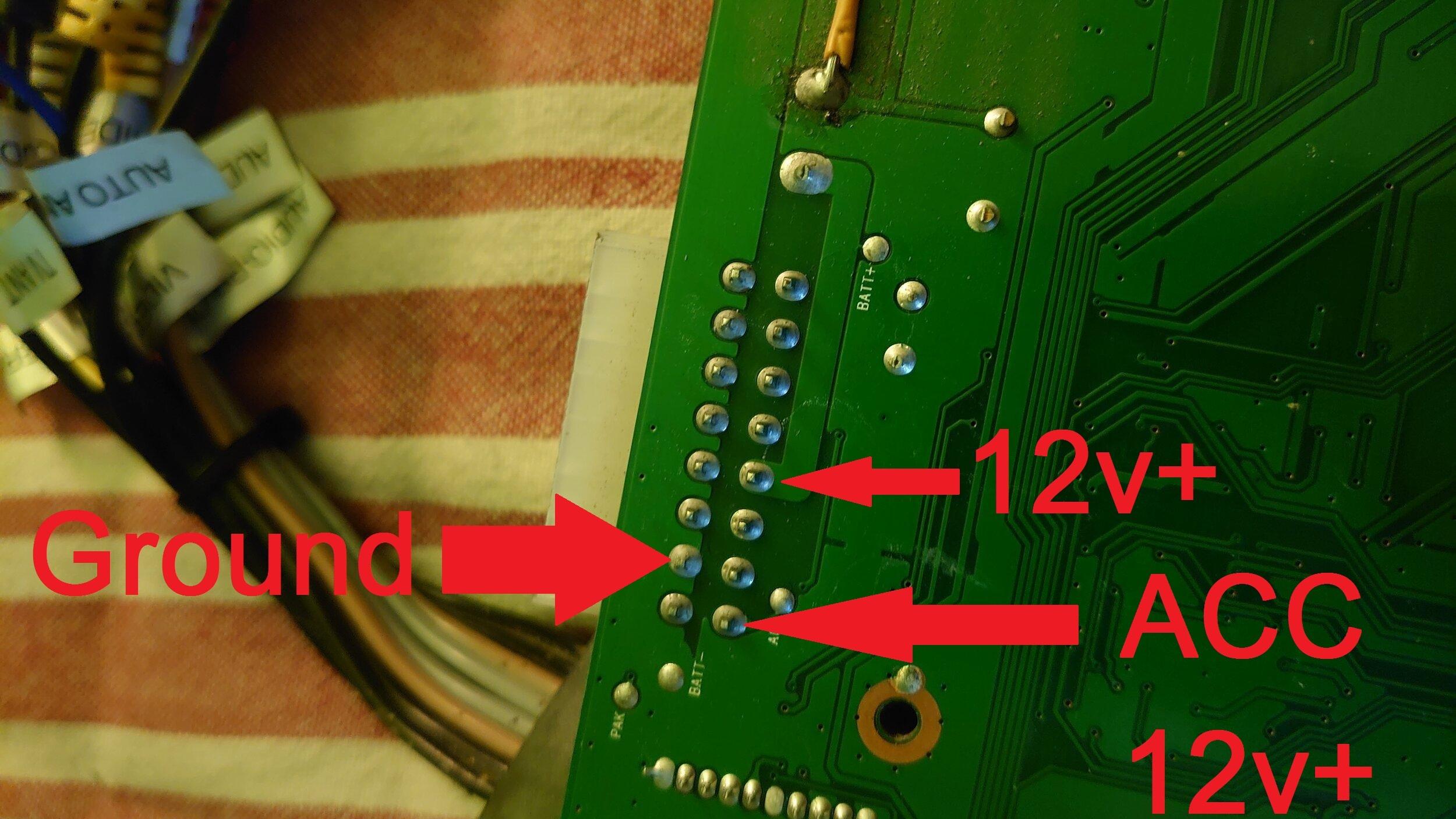

Well that does help at least, now you know the ground, 12v+ and ACC wire, so you can power the stereo on.
I was typing a response telling how to use that big diode and inductor / ohm meter to find the 12v wire, but being printed on the board makes no need for that. At any rate, once you get it powered on, a volt meter will be handy to find the power antenna and remote turn on wires (12v output when stereo / radio on), and then can carefully try to test for AC output for speaker wires playing a music / test tone if available. Or find the chip-amp IC and see if you can find its part number to see its pin-out, then follow the speaker outputs to the correct pins, it's already pretty far disassembled.

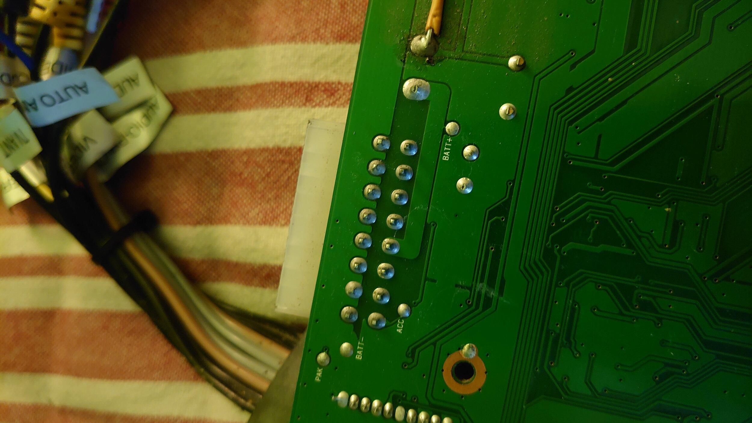

Well I couldn't find my multimeter, so I made a test light and this is what I found out...
So there are 11 grounds... and If I connect one wire from the light to the "BATT-" labeled solder point on the board and connect the other to one of the pins I marked with a blue minus which are the grounds, something clicks on the board, and the bulb lights up slowly...
And If I connect one wire to the "BATT+" and the other wire to the "BATT-" the light turns on so I guess there is a short somewhere...

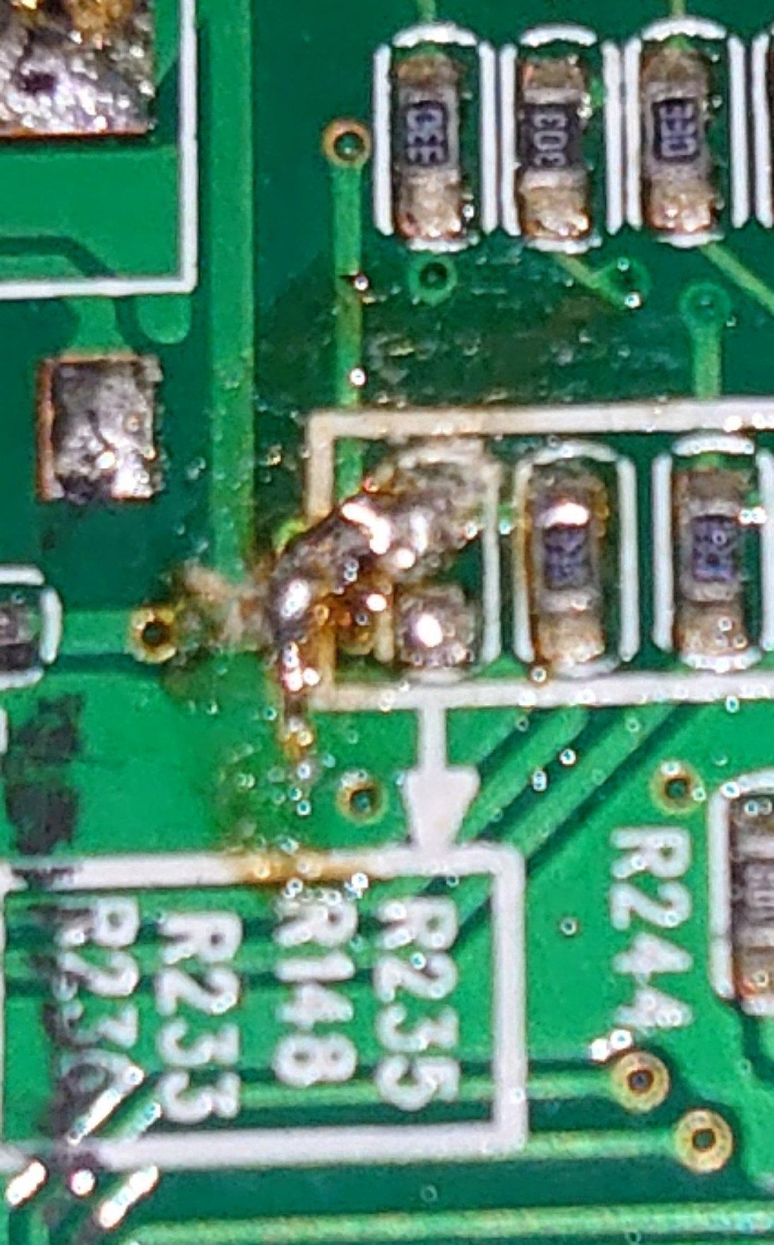

I might have found the issue

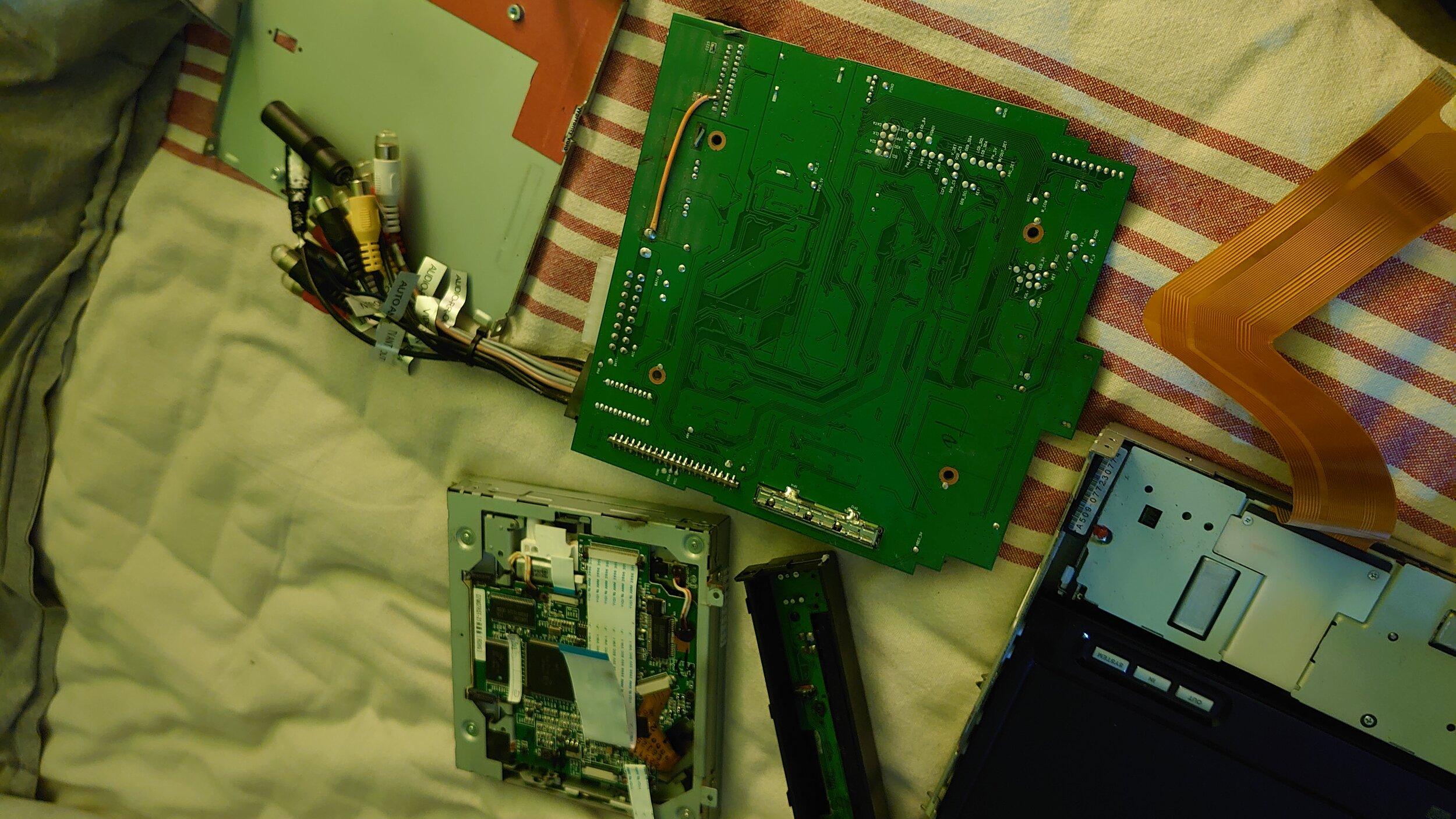

It could have a blown amp-IC chip too. Looks like someone installed a “bodge” “track repair” wire at some point as well (the yellowish wire on the solder side of the main board).
It may still partially work, so won’t know until you try.
I had an old 90’s Pioneer head unit back in the day with a blown chip-amp IC so it had no output to the speakers, I removed the bad chip, fixed a couple bad board traces, but the RCA outputs worked fine so it still ran the whole system as I had external amps.
That said, I’m guessing it is a cheaper brand head unit, and like not worth putting much effort into repairing. If it is dead I’d personally stick it in the parts box. If your unit was ever hooked up backwards it may have too much wrong at this point.

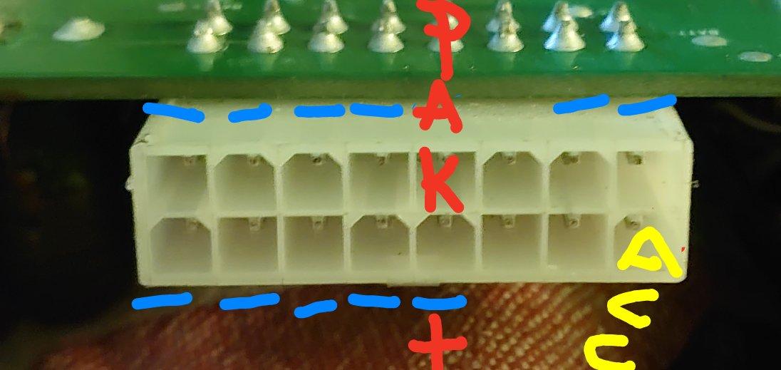

But yes, if you were to try to power it up, these are the 3 pins you want as far as I can tell. The 12v+ and ACC both connect to the battery 12v+ terminal for testing purposes, and ground of course to battery negative. This should allow it to fully power on. The other pins being tied to ground may be from a bad output chip, but might not know until you test it, and perhaps the light bulb tester is making the circuit act unusual, not sure.
