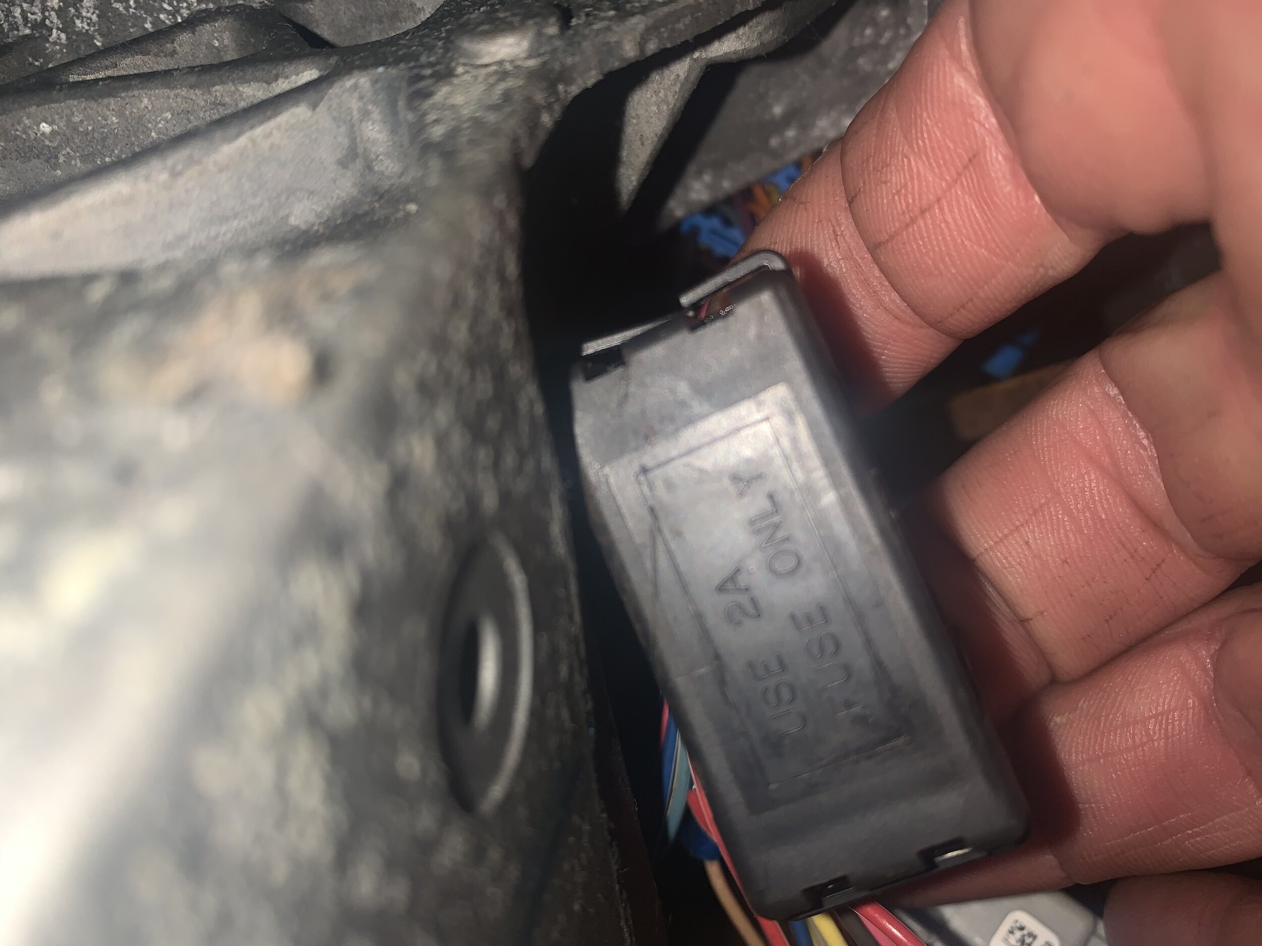

I'm working on a friend's newly purchased '04 Cadillac CTS. The headlights will not turn on. Both highs and lows. I've replaced the bulbs, combo switch, relays, and fuses. I'm running the wiring now and I run into something that technically shouldn't be there. It's a 4 way mini fuse block. The mini fuses look to be good but I'll replace them for good measure. It's only 2 amp max so it wouldn't run the lights directly but it could run the controler, switch, etc that runs the lights. I can't get a great pic but I'll post the best I can get.
Anyone have an idea with this could be to/for? I'm guessing it could be for a car alarm but...

Always start with a multimeter and see whats getting power and where it's stopping at.are the light sockets getting power? Check the harness and junctions. Then the fuse box. Then the switch. Randomly guessing and replacing parts isn't the way to go about it bro.

It ended up being the fuse box with an additional kink. It's to a trailer hitch wiring harness and the last owner hooked up the headlights instead of the parking and brake lights.
That's all I needed.
