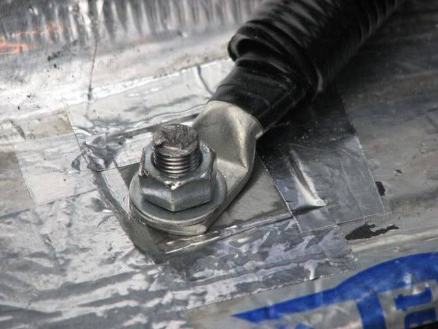

you want a very good ground, i recommend bolting to the floor.

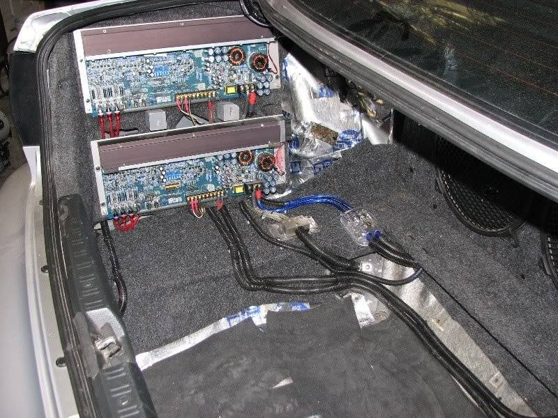

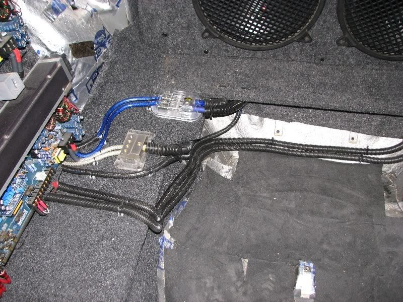

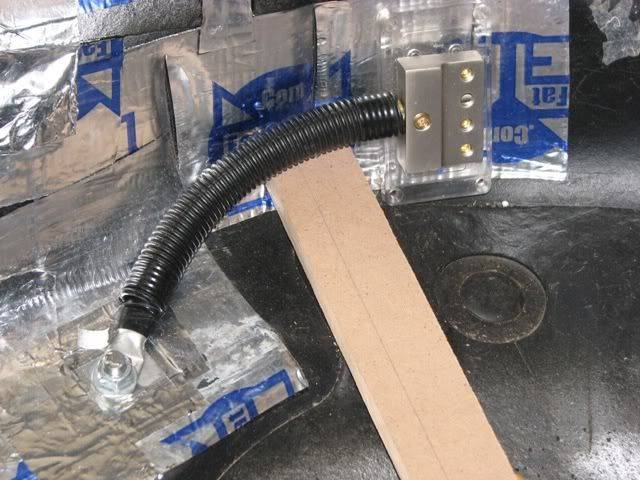

this is how my amps are grounded.
i used silicone to hold the ground dist block in place in this pic. silicone is an excellent adhesive for holding things to metal in the car. and it is removable (with some effort). it just stinks for a while. //content.invisioncic.com/y282845/emoticons/smile.gif.1ebc41e1811405b213edfc4622c41e27.gif

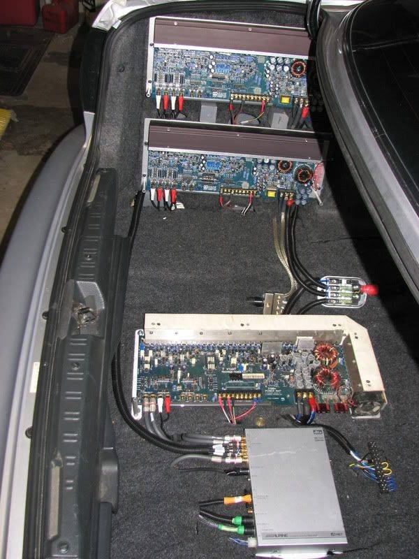

examples of multiple amp wiring

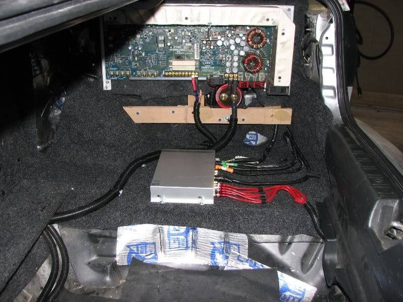

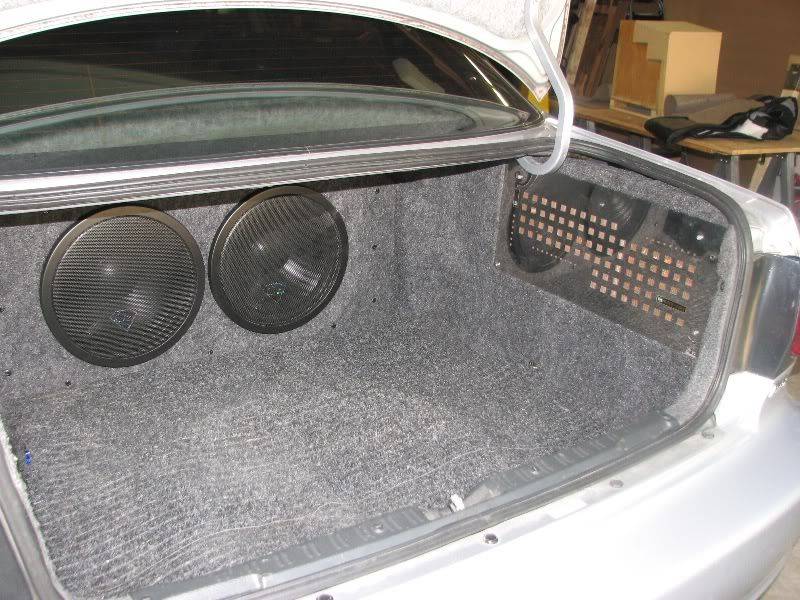

when i had an amp and processor in the spare tire well:
then i added a full size spare and move the gear to the other side
i also redid the power and ground distribution. the passenger side amp is now grounded to the floor separately from the driver side amps. the goal for grounds is as short as possible and to the thickest metal on the floor. that expanse of metal is a better conductor than wire (in some cars). dedicated ground wiring to the batteries is another option (if you want to use 2x as much wire). grounds should always be the same size as power wire.
covers on and mats on the floor (which i use to protect the amps/subs if i load up the trunk with stuff)
