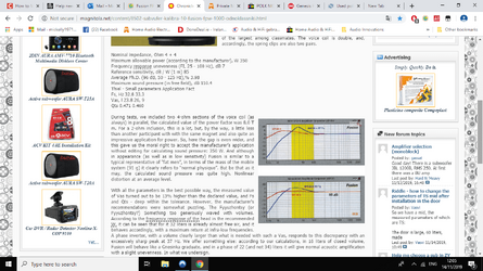

Well it turns out both amps are dead in the water. so I am on the hunt for something that will match. I have attached pic of one of the only bits of info I can find on the driver. Its a
Fusion FPW-1000

So im trying to work out if its
DVC@ Ohm 4 + 4
Maximum allowable power (according to the manufacturer), W 350
Does this mean it is 350 rms per coil or in total @2 ohm or what?
Sorry if these are really simple questions it is just I really dont have a clue how to work out what im looking at
