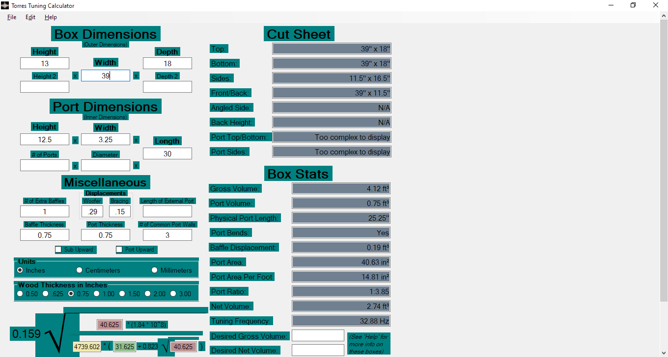

14-16in2 of port in 2.5-2,75in2 of net volume ought to do it for a SINGLE 9512.
That's roughed in with Torres only. If I had to design something I'd take the time to model it for sure... then draw it up.

Great that you are trying to diy the thing... it's not a draw up. Its Torres... not an app but a program and I use it to rough in size only.

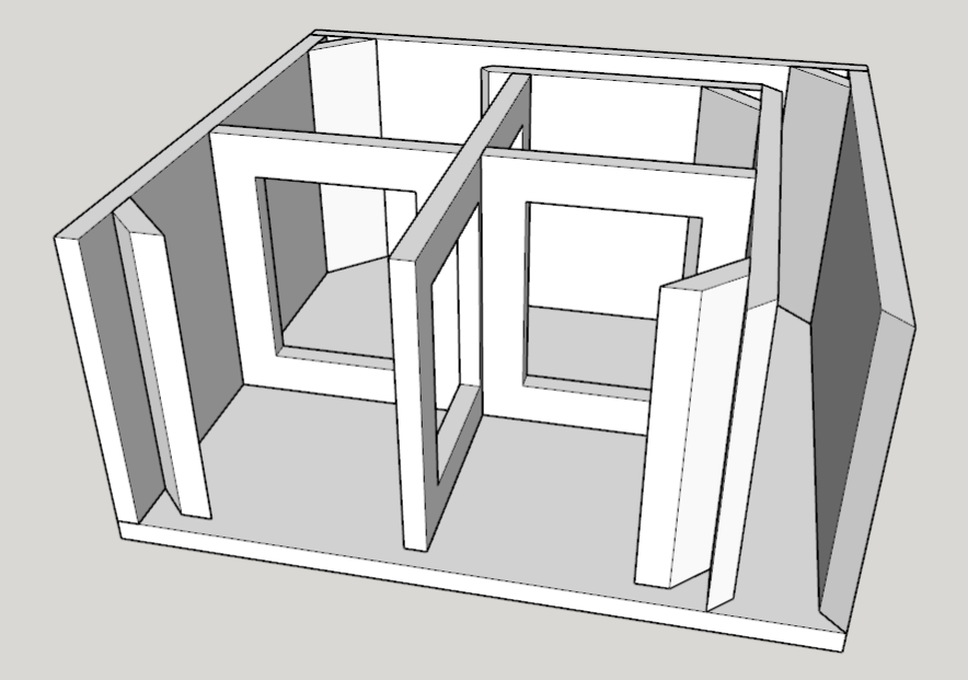

This is a design... modeled in 2 programs BEFORE being drawn up in Sketchup. Its accounts for Cabin, tuning, volume/power and is as accurate as I can do. (not very... lol)
Its 9 pages with cutsheets.. If I might suggest getting together with a designer since you appear to really need help to me. I wanna sell the next guys subs as much as the next guy but a 9512 @ 1 ohm on a m3 sounds like something I'd run myself... so understand your equipment and settings... you can be a "user" or someone who knows their system and its limits
