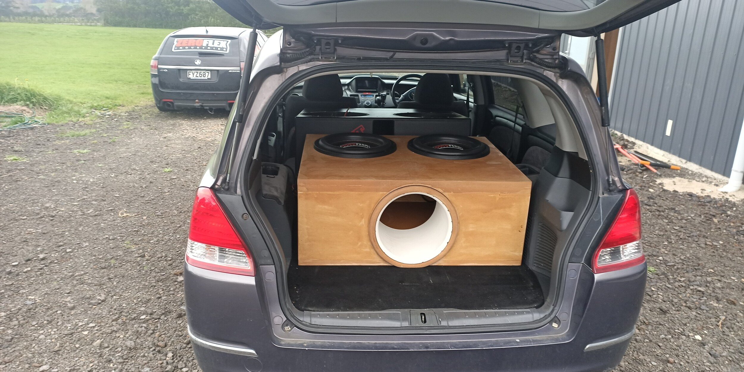

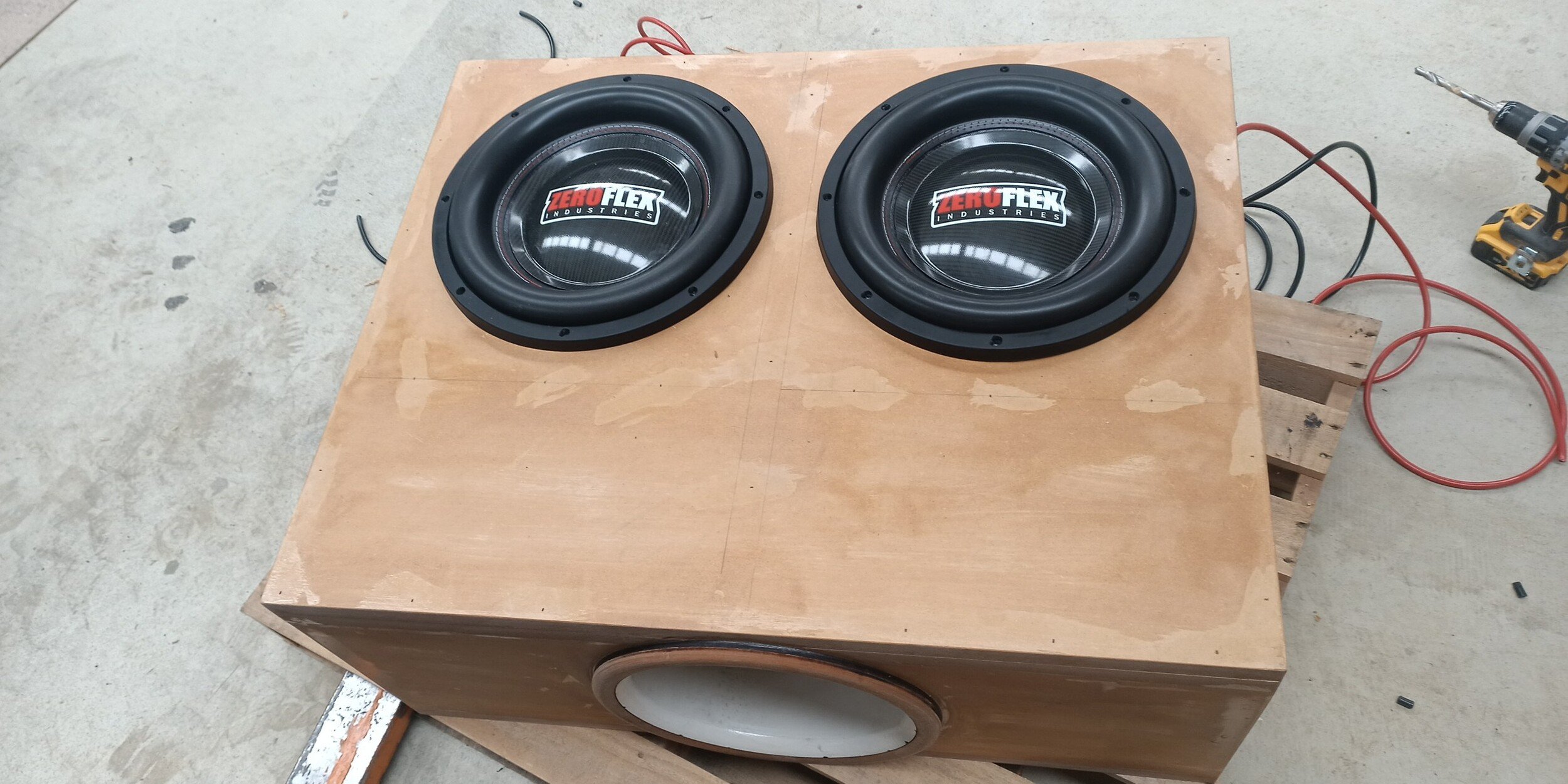

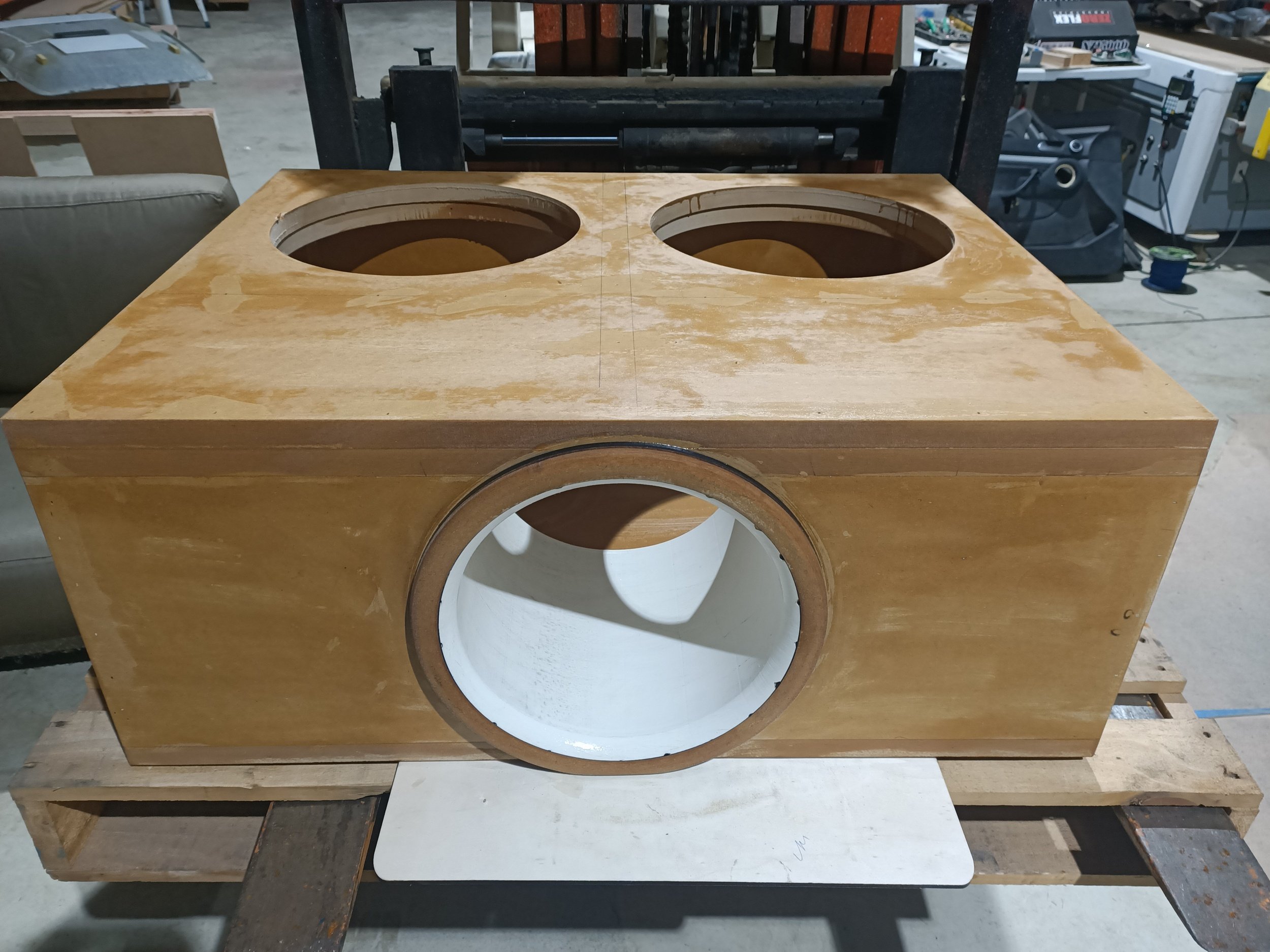

Hey guys and girls. I'm having an issue with a burp box I've just build. I have the plans given to me by a freind know has made a few diffrent style burp boxes but for some reason this is not hitting what I thought it would. My aim is 155's on 5k in a minivan/wagon setup.
My system is:
1 x ZeroFlex 5k
2 x ZeroFlex EVO 15's
3 x 100ah lithums
1 x 500farad cap bank

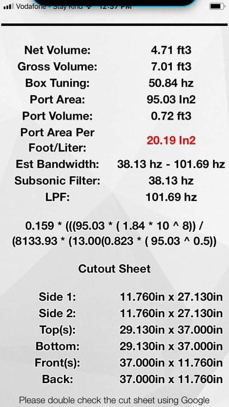

I've attached the spec my mate gave me and pix of the box, the port is 11" round x 13" long internal.
I am thinking of going 45's internal and changing the port to a horn style starting at 9 1/2" internal Caming out to a 11" external at 8" out side the box.
Currently only managing to get 149.8 at 46hz out of it sealed on dash which is way off where I'm aming for.
Cars resident frequency is 56hz.
Any help would be greatly appreciated thanks

First issue I see is that the box is too small by half. Try 10 cube net 20" port per cube 17" port depth then shorten the port a little at a time until you stop gaining (your peak may change so test test test and keep notes of what you changed and your peak freq and number). That said, 20 square inches per cube may be impractical, you may have to sacrifice port area if it's just too big to fit on your box without crowding something or whatever.

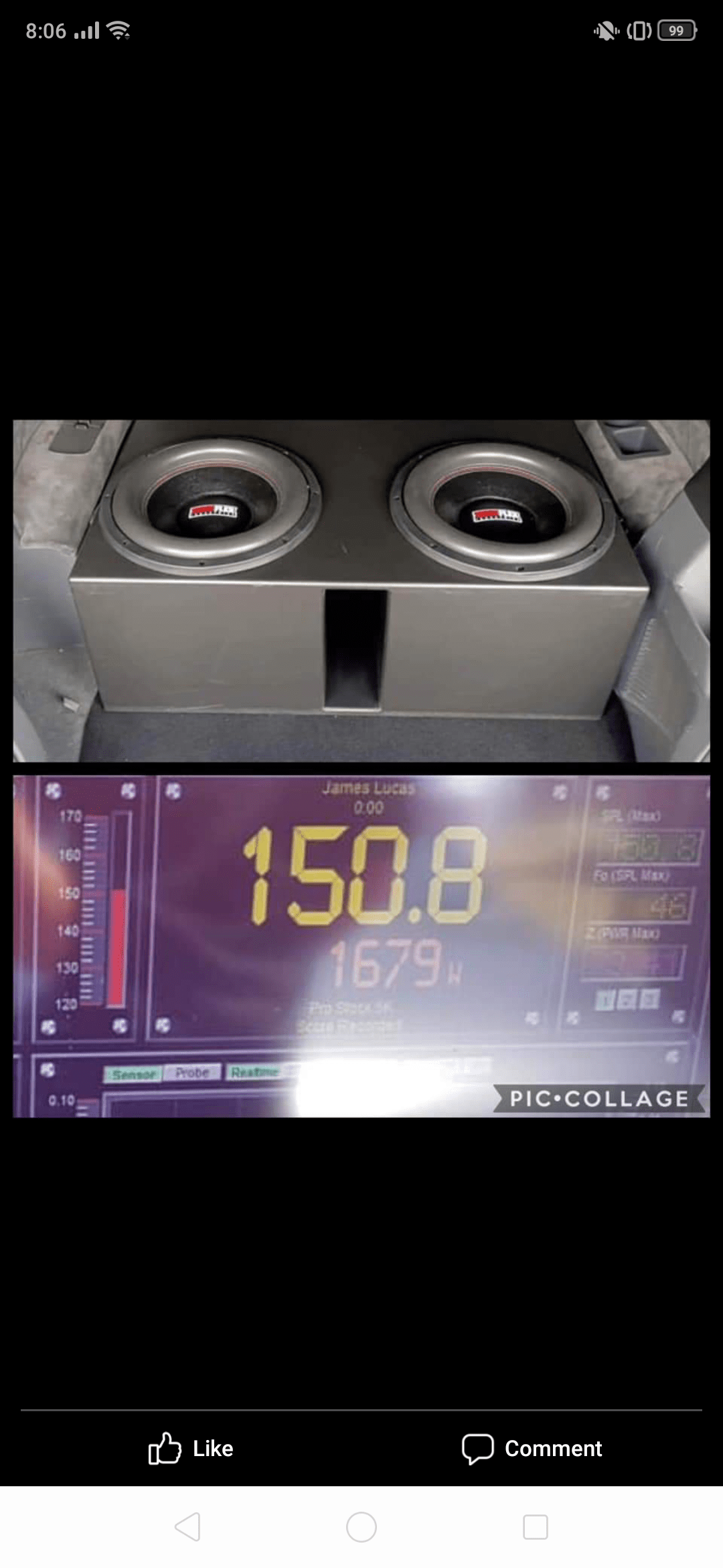

The vehicle is a Honda Odyssey, subs are wired to half ohm cars fq 56hz. My other everyday drop box is doing 150.8's sealed on dash on the same amp with the same subs. Have attached pic of the two different boxes the burp and the daily drop box. I know I can get more out of this burp box just scratching my head as to what to change and try.

Thanks for the reply. Have added a post with the pix of both my boxes in my wagon. One is my daily drop box doing 150's with that one the second is the burp box. Cheers

With my current daily music drop box my best on music is a 150.8 at 46hz. I might just try some testing from 40 and up to see any difference. Thanks for the reply
