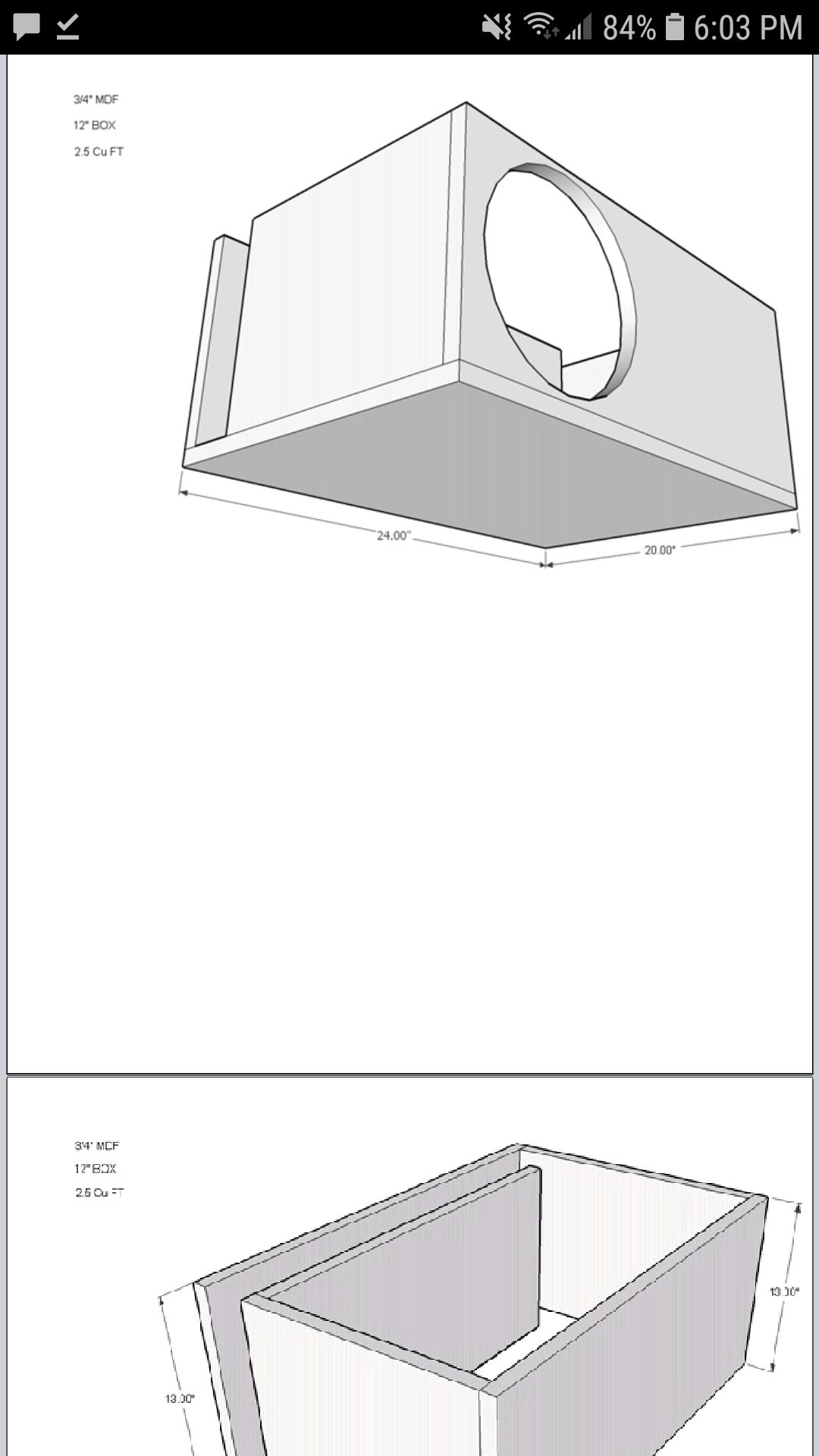

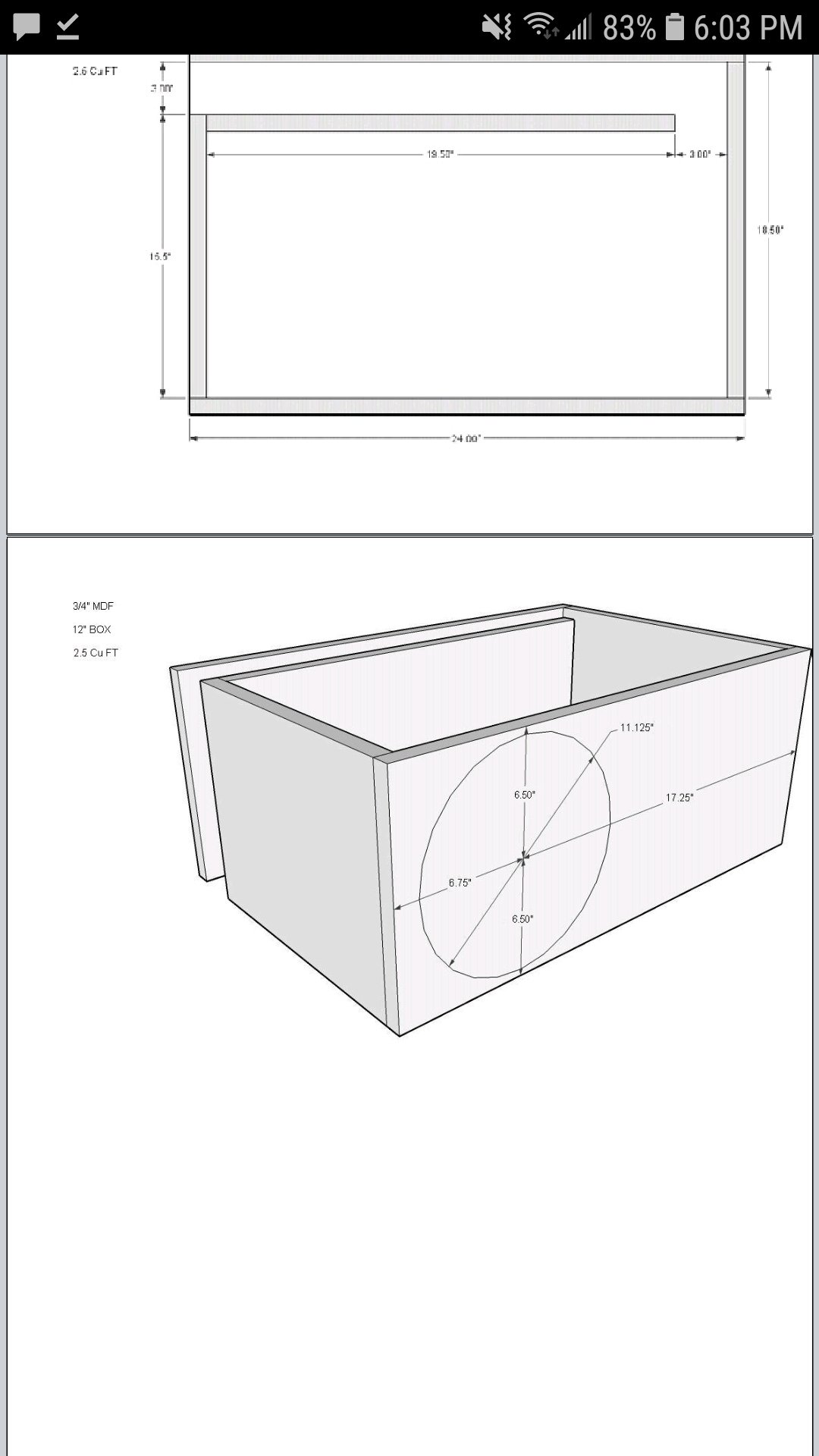

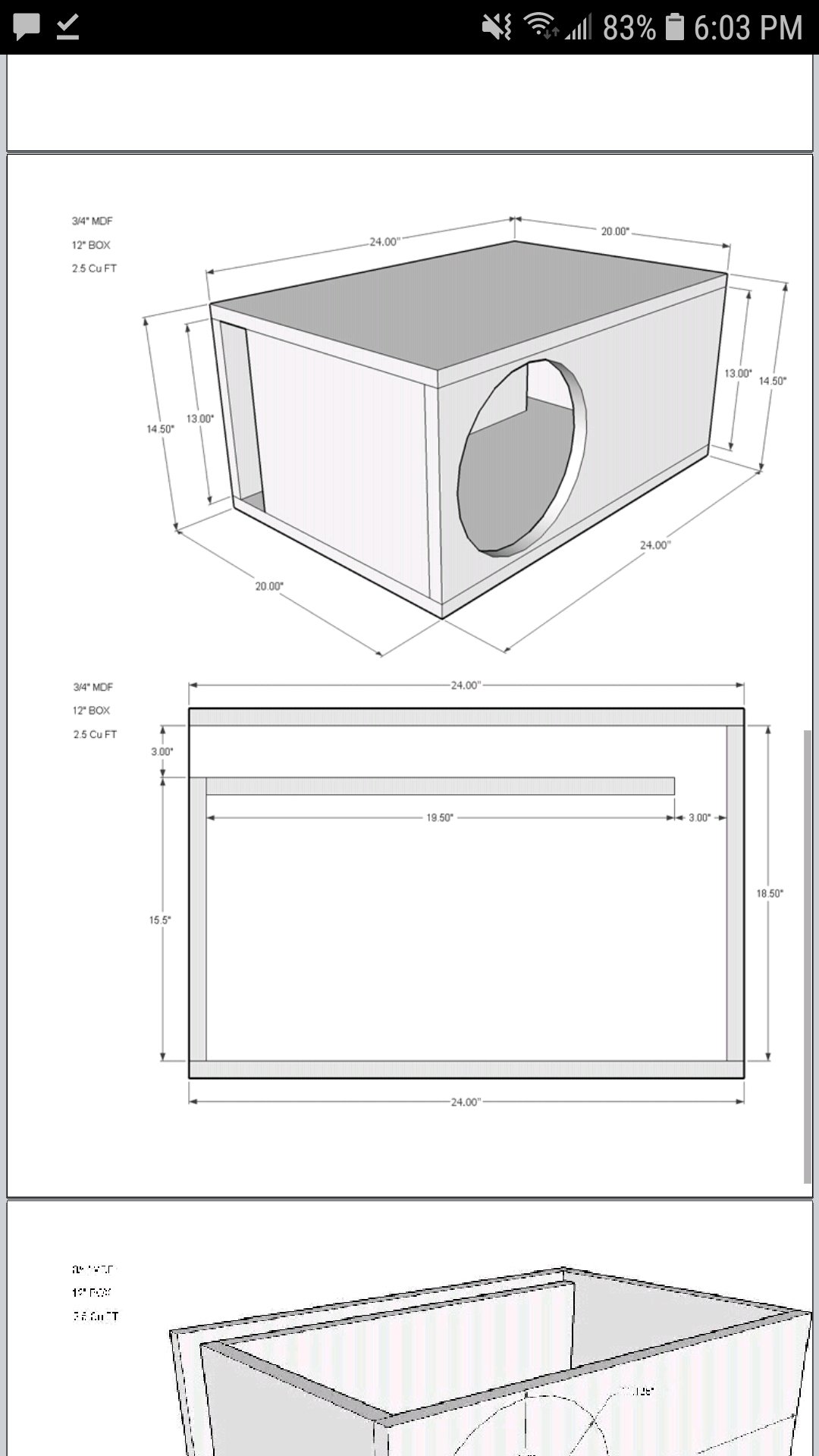

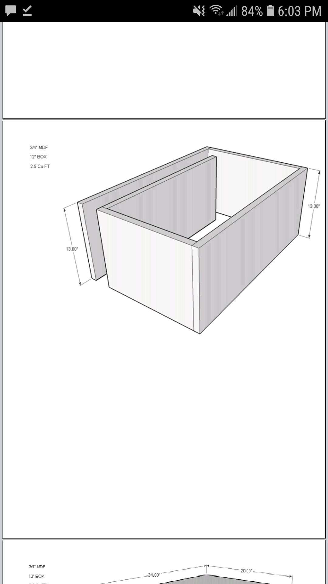

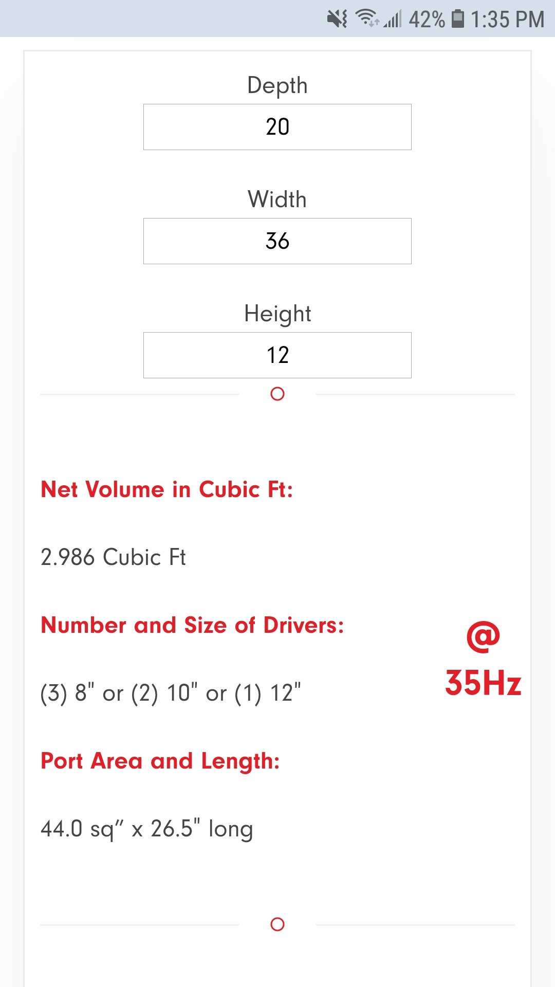

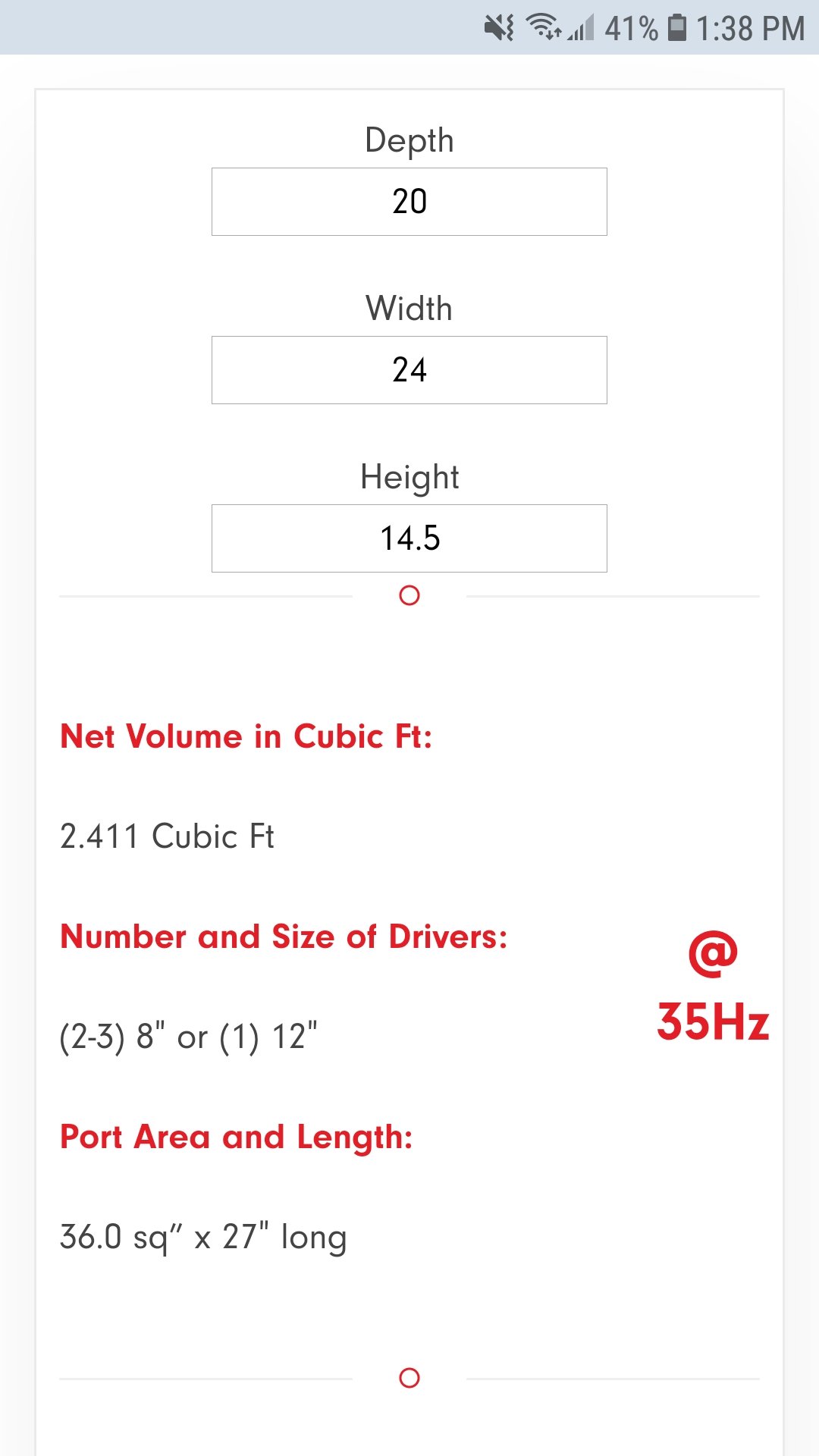

So im looking into running a 9512 on a m3a once i get the sub rebuilt. Car is a 73 chevy nova. 160 amp alt 1/0 with amg battery in trunk.
So last time i ran a 9512 i used dd compact box plans . But different car i want to use something close to their design or something that will fit. When measured i have 40 wide 13 high and 20 deep. Because of the height im not able to use dd box plan so i was hoping to get some help with making the height with

out fffff up the box. Any help with this would be great
For the 9512 g it looks like you have the right airspace ...they need 2 cu ft plus port ... port opening needs to be 32sq inches ...and 18" long ... rear fire the subwoofer ...double baffle the sub board it's a 60# subwoofer ...and make sure you position the port to load preferably passenger side about 8" from shock tower side .

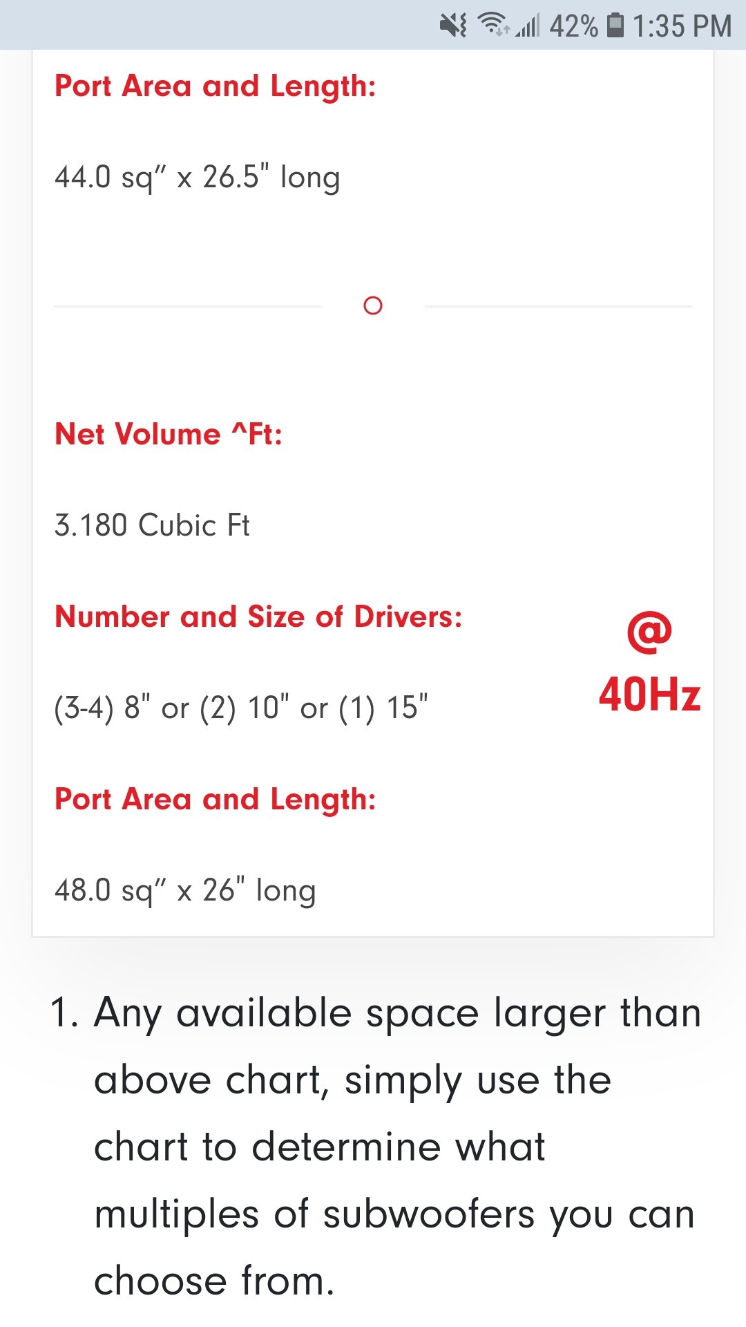

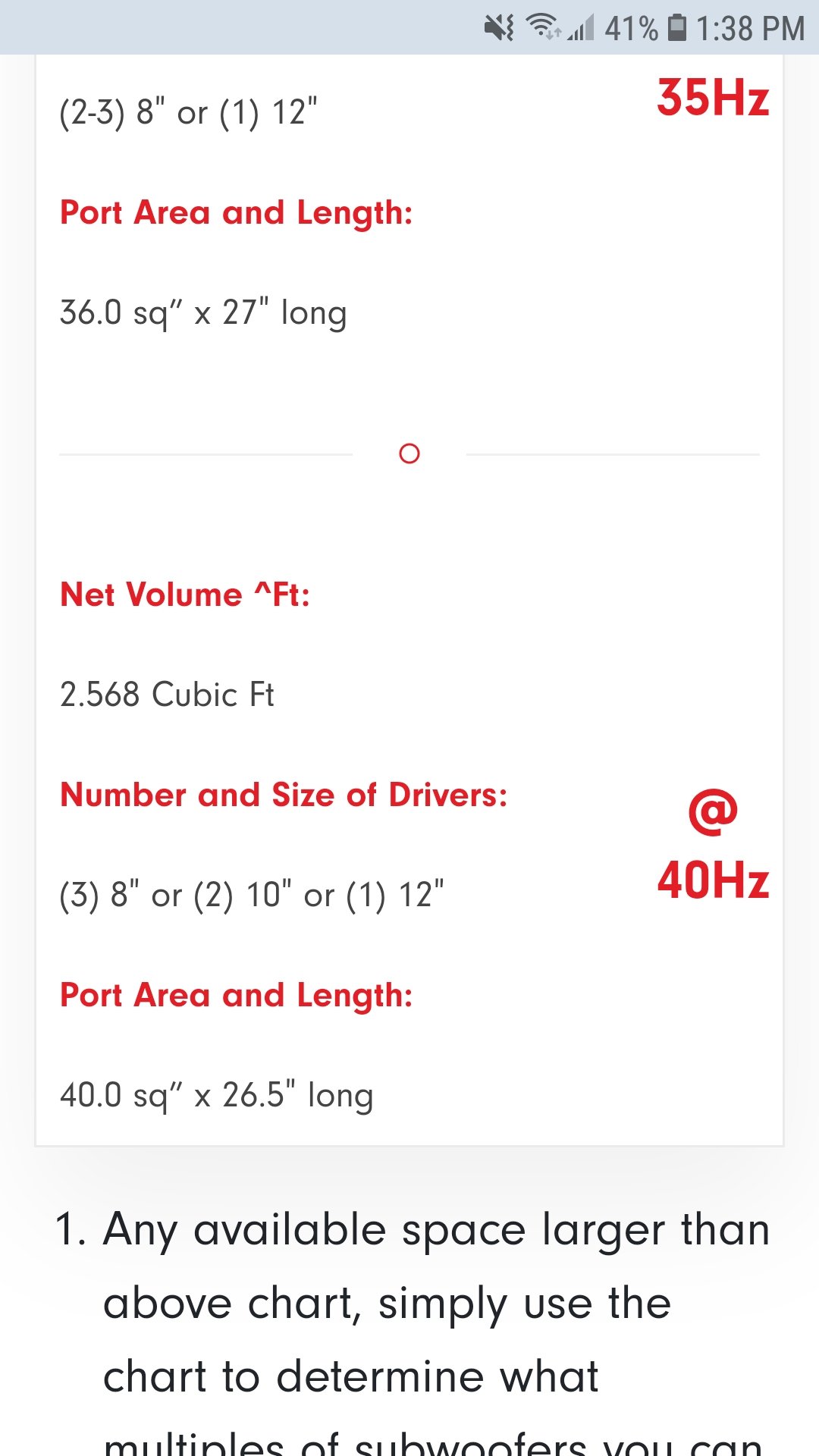

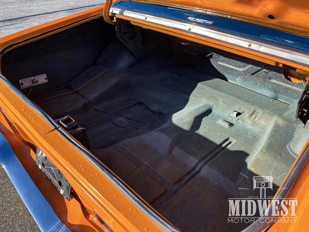

Yeah that is just from dd site. But it won't work in my space. Im Wondering if i can reduce the height and mount the sub firing up. The nova trunk is tight and i want to keep the enclosure as deep in the trunk as possible.
That box needs to be bigger. You really should be aiming for 2.5-3 cube NET (volume eaten up by the wood, sub, and port doesn't count) and you should stick to 15"^2 per cube port area 18" deep.

I would love to do 2 10s but i only have one motor and want my amp and sub to matxh if possible. Finding dd gears is a bit tuff as well. It seems my limitations on height is killing me. Im also open to doing a 9510 which would still slam. I just need something i can feel in my chest so i want to tune low like 32-34. I believe the dd boxes they have plans for is for a 40 tune.

Well i guess i would have to find a program or have somone draw me up something to fit. I can go as wide as 40 and 20 deep but height is super tight. I have to measure again but i believe 13 inch is my limit. I can probably remove the trunk lid torsion bars to gain a half inch lol.

40x20x13 is plenty of space to build a good single 12 box with plenty of room to spare. Just put together a spreadsheet or guessing and testing numbers with a piece of paper until you get 3 cube net internal after subtracting port and say .15 to .2 cube for the sub.

Lol. Can't remember how much space is needed between the subwoofer and a hard surface. but even if i top mount the sub i dont believe i would have enough space. I will have to do some more measuring to be sure. Main thing is that i want to get the box under the rear deck to have clean look and space. If not the 10 works for me as well.
