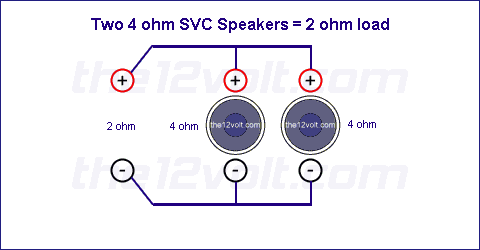

Your amp's 5th or sub woofer channel will produce 300 watts at 4 ohms rms. If you were to hook up a single 4 ohm woofer to your amp, it will provide 300 watts rms (rms = continuous watts) to the woofer.
That amp's 5th channel is 2 ohm stable. At 2 ohms, it will produce 500 watts rms (continous). In your case since you want to add a second woofer, I would choose (2) 4 ohm woofers. By doing so, you will present the amplifier with a 2 ohm load by adding a second 4 ohm woofer to the amp. Hook both of these woofers up to the amp's woofer channel. Here's an example from the12volt.com.
21918
When selecting your woofers try to match the woofer's power handling to your amplifier's power output. 2 12 inch woofers that handle 250 watts each will work fine. Be sure you have enough room for a proper size enclosure or enclosures for your woofers. If the box is incorrect, you won't realize the full potential of your woofers.
