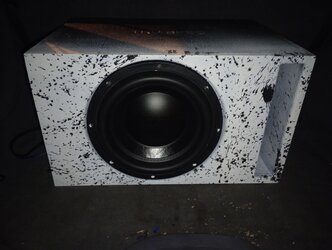

I talk about these boxes a lot, maybe cause Im biased, but they are just great boxes
You'll have to paint it and get some copper bolts, washers, and nuts for the terminals but these boxes are sturdy AF, displacement taken into account already so you don't have to worry about the tuning being affected, and a recessed double baffle makes it look clean. The biggest downside is that is have pretty much nothing to give below like 28 hertz, but I don't listen to much with windy bass anyways so that doesn't bother me much.
Did mine with 3 layers of roll on bedliner and satin white spray paint. Love the textured look of bedliner
