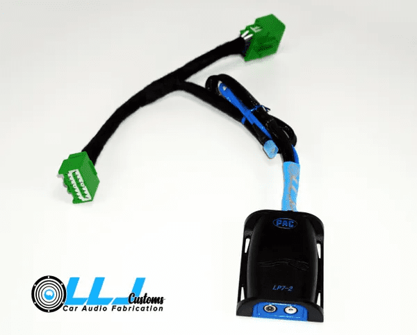

Contact Crutchfield.com and ask them if they have a T-harness to fit your need. It should be similar to this:
