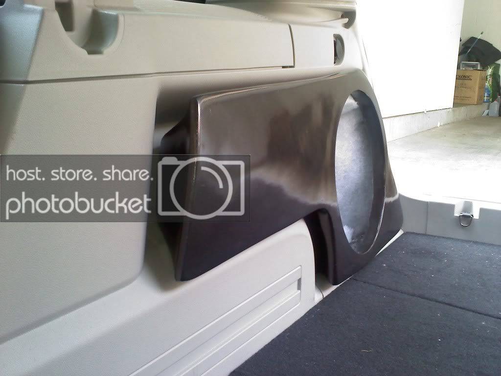

I currently have 2 Rockford Fosgate Punch Ps3D412 12” Dual 4 ohms Shallow mount subs installed in fiberglass pocket enclosures, and they ****. Given my amp specs, and enclosure info(depth, airspace, etc), can you recommend subs for me? If possible, I’d like 3 recommendations, High price, medium priced, and bang for buck price?. Here’s the info:

Fiberglass Speaker Enclosures Specs(see pic):
• Product dimensions: 750x450x250 mm.
• Appr. Airspace: Rt- 0.65 cu. ft. ,Lft- 0.71 cu. ft.
• Mounting Depth: Rt- 7.2 in. Lft- 8.1 in.
I posted in the Stereo Integrity forum and here was the jist of their response:
The box volume you're working with is also a bit large for a BM mkIII. See our FAQ thread and you'll see box volume vs power handling in there. And with the depth of your enclosures (close to 8"), you can almost use any subwoofer(s) you want...besides the low internal volume issue.
So I guess I'm looking for a normal sized (non-shallow mount) sub with max 7" mounting depth that will work in sealed fiberglass enclosure with .65 cu. ft. of airspace

What are you after? Better SQ, louder and deeper? That tiny sealed fiberblah isn't going to give you eye watering bass even if you install a Warden in there. If you're after smooth, deep n loud bass then I suggest you to ditch that pocket box and make a bigger ported one(1.5~2 cf with polyfill) so you can install a beefy sub.
0.68 cf(remember the sub will displace some volume too) is for 8 inchers, not even the awesome old-school round Solo-Barics can work with that tiny hole.
Yeah, I need the space in hte back of my ride so I'll have to make due with whatever works best in those enclosures. Ideally louder and deeper, but if that small airspace will only get me better SQ then I'll take it. I'm just tryna find something that's sounds better and/or is deeper than the weak sauce RF PS3D12 shallow mounts I have now. I had two Alphasonik PSW812's in there for a while, but blew one of them. They sounded better the those **** RF's I have.
