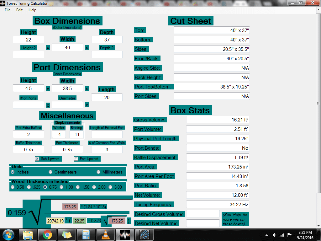

Here is a sample box design It'll be bottom slot port.
i think it might cost alot maybe half that size so i tried this

just got the subs in there huge and very firm sweet!!!! i ordered 2 seperate heavy duty 18" 1" mdf sub boxes 7.5 cf tuned at like 32 hertz on there way ill try them out it will fill the whole back sweetness
