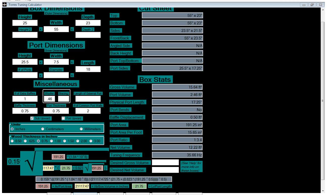

Im trying to get back into box designing, but im not 100% how to use torres box calculator.

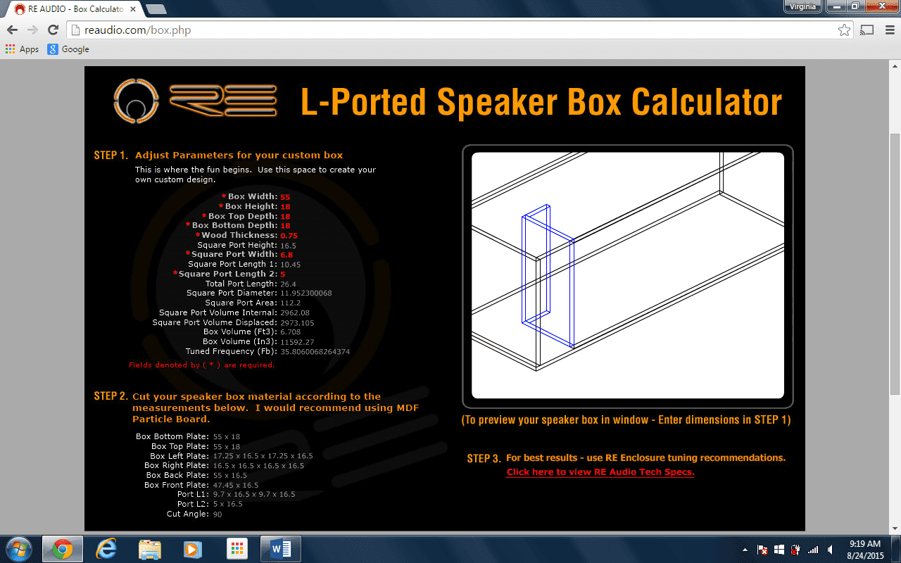

Here is a basic look from re calculator of what im trying to get.
I know RE is not 100% so if anyone can help me out id appreciate it.
Basic points needed for box is:
- Box width needs to be 55in or less
- Box height like to keep near 18 or few inches taller to keep below the window line
- box depth has to be 18in or smaller
- Box tune 35hz
Hoping @CSCStang can come thru :D i have beyond bothered the cr4p out of him

REs calculations are spot on but how are you gonna mount 18s on an 18inch tall baffle? Bump it up to 20 inches tall and don't forget to consider any doubled up panels you might use. The baffle at a min needs to be 1.5 inch thick so that adds .75 inches to the port length. I'd brace it very well. Those subs are gonna flex that box.

I considered double baffle on top since it will be subs up port forward.
Would you consider few inches taller and double baffle all around?
I planned to do 45s at each corner so i probably need to factor those in :/

I"m just saying you need a baffle wall taller/wider than 18" if you're gonna get screws through the mounting bracket all the way around. If you can get the top and bottom depth to about 20 inches then use 55 wide, 20 deep, and adjust the height accordingly to get the volume where you want it.
