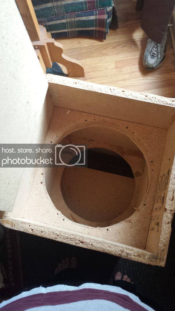

I built my first box as a 16 year old kid. and it was this Decware's Death Box Car Audio Subwoofer Cabinet for Twelves
I Knew **** all about car audio, just had a friend that said that design was supposed to be good.

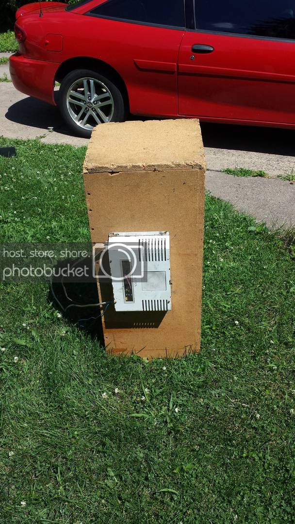

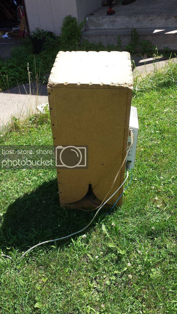

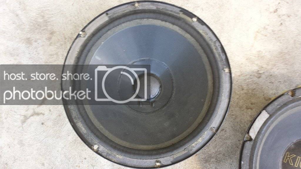

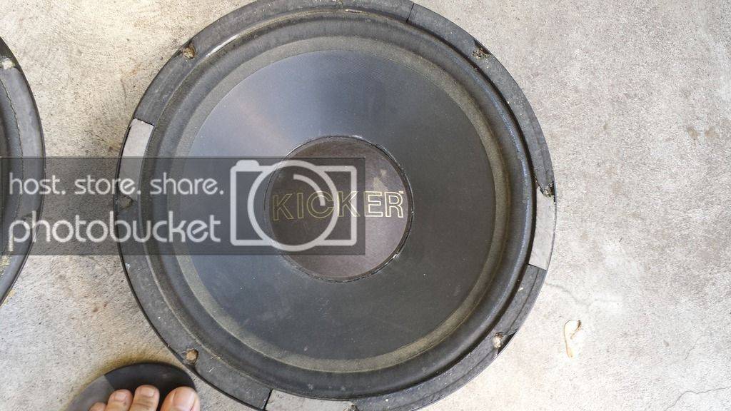

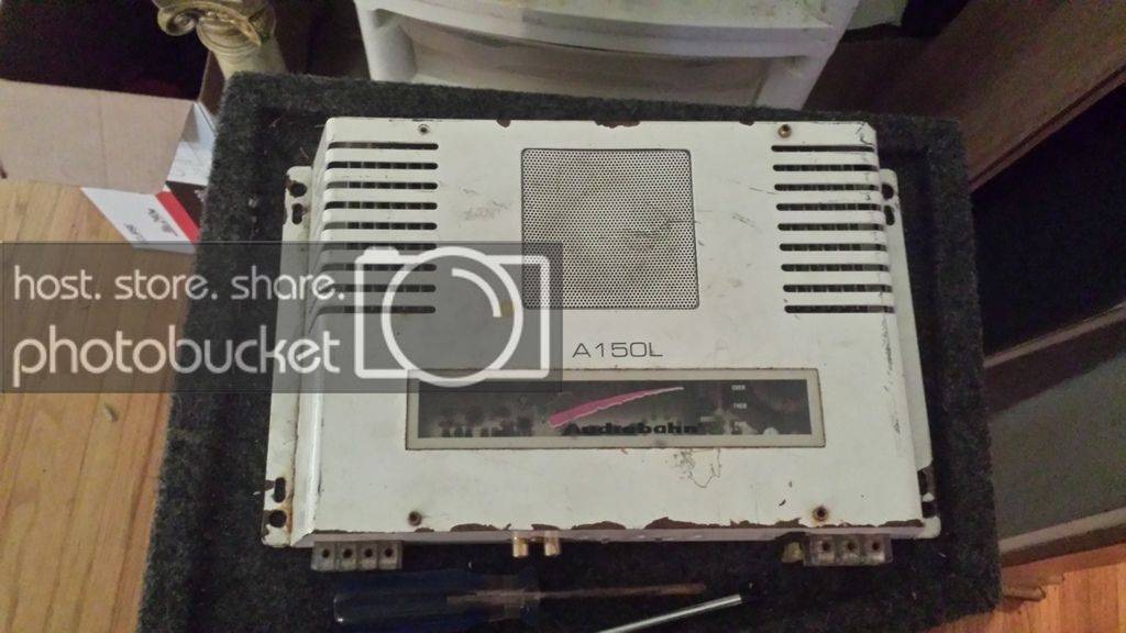

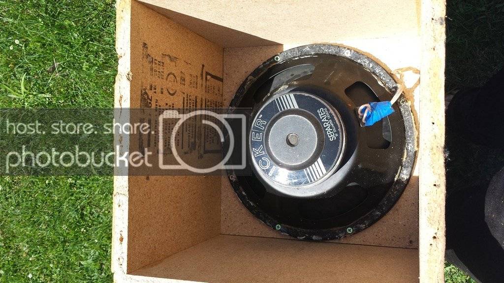

I had no real extra skills as a carpenter, i was a dam kid. But I made my way through the design and cut sheet. Then glued and screwed it together. She wasn't the prettiest box and the equipment was just hilarious. Some really frickin old Kicker 12s with paper cones and foam surround that was deteriorating. These were clamshelled together in the self made box and for an amp, just a little also very old audiobahn 150 watt. But that moment when I realized that my substage sounded cleaner than everyone else's and louder than most with this old low power gear I fell for this hobby. I've never since bought a prefab box nor would I. Ask anyone who has ever built their own box on here, even if it was ****** the first time, they will tell you it's worth it in so many ways.
Oh and pics or it didn't happen right? Well I still have the gear, was actually just about to get rid of the box, Here ya go:
Only a few more boxes later I still love building Decare designs:
I always have room to improve on construction, I still have tons to learn (I don't do this professionally or very often). But I think you can see as you build more your skills improve, and you can get ideas from build logs on this site, there are literallllly TONS of them.
