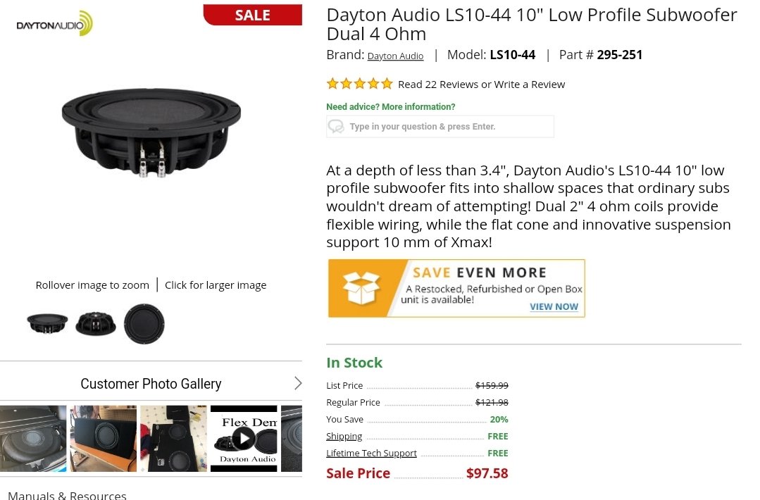

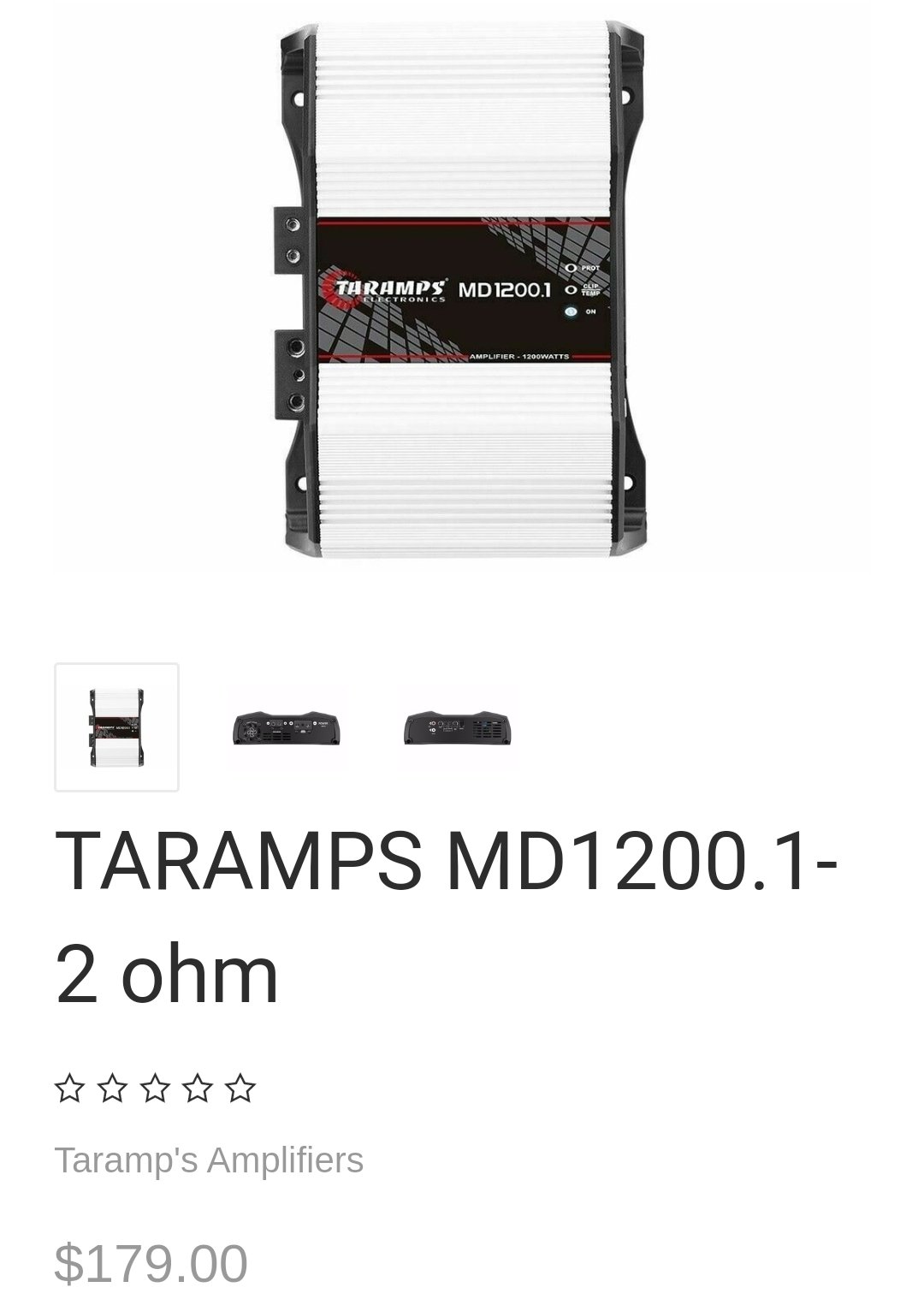

You could put two or three of these behind your seat in a sealed box on a Taramps MD1200 for under $500. Dayton makes some very nice subs. The subs only require .45 cubic ft. sealed for each one.
