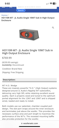

I have a single 10” JlW7-3 in the red eye box. I want a really high quality amp that I can find pre-owned for a good price… what are the best ones you would recommend and why?
factory specs:
Continuous power handling 750W RMS
(1500W Peak Power)
3 OHM Mono
Frequency 20-250 Hz

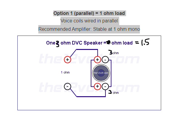

Would running it at 4 ohm 950 RMS be ok for the sub even thought the specs recommended 750 RMS?
You're fine. You will run it at 1.5 ohms most likely. That is both coils wired in parallel to a single amp output.
EDIT:
Doesn't apply on a single 3 ohm VC sub, sorry.
Ok, now that makes sense. Thank you!!
