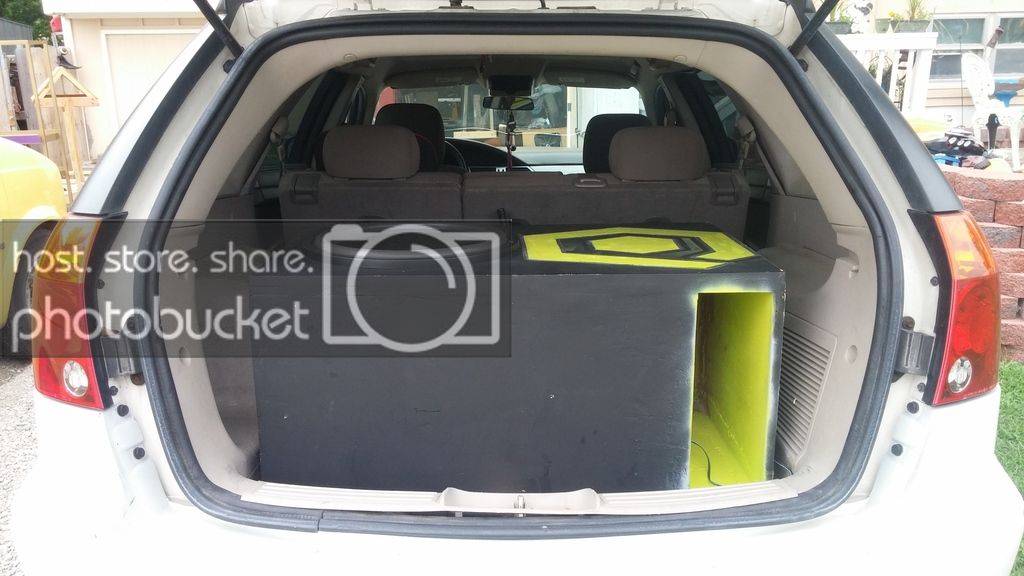

I just recently got my hdc3 18"......It's the first 18" i've owned and holy ****! It was well worth it ha.....anyways, I currently have it in a 6 cu ft@35hz slot ported box with a 6" port in an 05 chrysler pacifica. I'm running a kicker kx2500.1 with a yellow top under the hood and regular battery in the back....****** I know....but it works for now. Oh and stock 140 amp alternator. I have it wired to 1 ohm, I had the gain turned up to exactly half and for some reason it started smelling weird....so I turned the gain down to a quarter and it seems to be doing fine right now. But it's not very loud. I know it has way more potential that what I'm seeing....So would someone be willing to help me out with a box design so I'm able to push roughly atleast 2000 watts to it daily? Thank you

Yes I know it's not 1 ohm stable.but I was ready a few forums and people were running it at 1 ohm....although they didn't say for how long lol.....I should wire it to 4 ohms just to be safe....or sell it lol. And yes I finally used a dmm to adjust my gains. But I was curiousand decided to turn it up to halfway....slightly stupid I know.....my max dimensions are 40 wide....30 deep......30 tall.....I don't mind using all my trunk space if that's what it takes......I just don't want a wall, I prefer to see out of my rear view mirror lol

Is the box sub up port back or sub back port back? If done right, your rear view should be absolutely useless
Voltage drops are definitely a likely issue, I was playing it earlier today for about an hour and my battery light came on while I was driving down the highway. Lol my rear view mirror is somewhat useless as of right now but I can still see out of it during certain songs lol. It's sub up port back

You mentioned "trunk". Can we see some pictures of this? The size and tuning of the box seem acceptable (though could go a little larger and tune higher IMO). Position of the box/port can be just as important or more-so.
