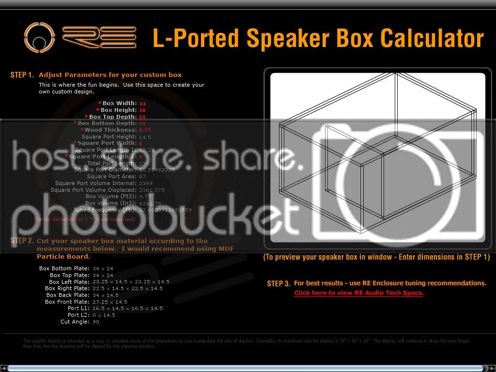

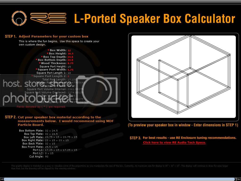

How does this look for a single HDC3 15" off of 1800-2000w? And will 16.5" be tall enough for the sub in the box? Or can I make it 16", because I'm not sure if I'll have enough clearance to fit in my trunk. If you got any suggestions let me know or if you can whip up a quick design for it.
Should be around 4.5 cubes @ 38hz after displacement.
But isn't it like 19.2^2 of port area right now? Unless I'm doing it wrong. If someone could make a quick design that would be easier than me ****in around in the RE calc cause I can't change port length. Width can be 30-34", Depth 20-25", Height 16"
