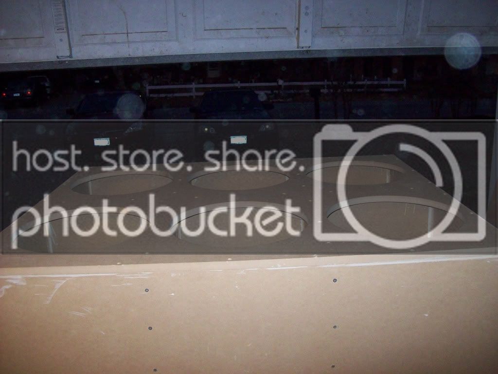

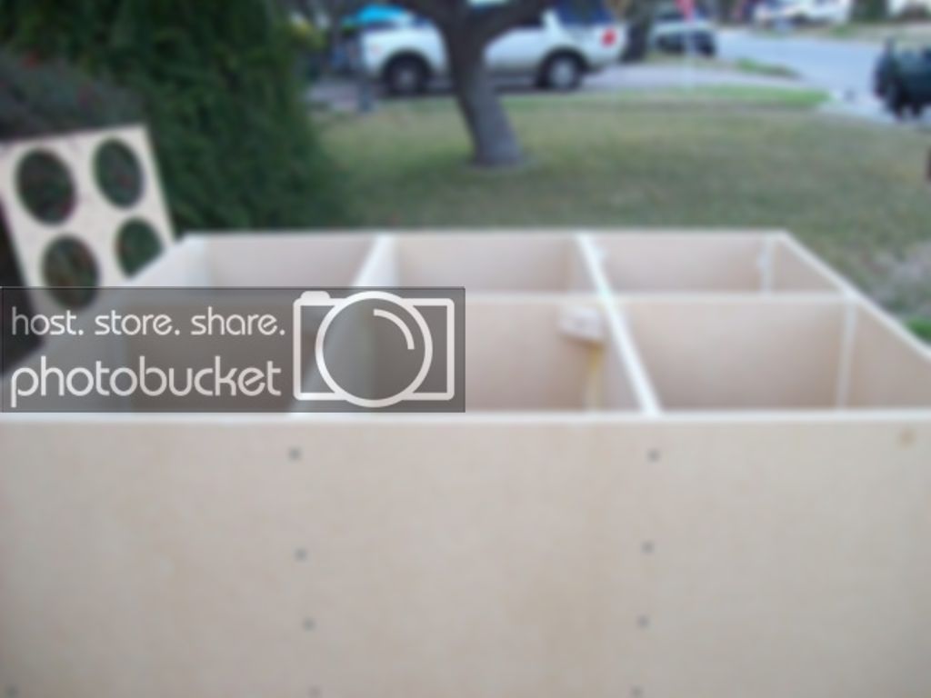

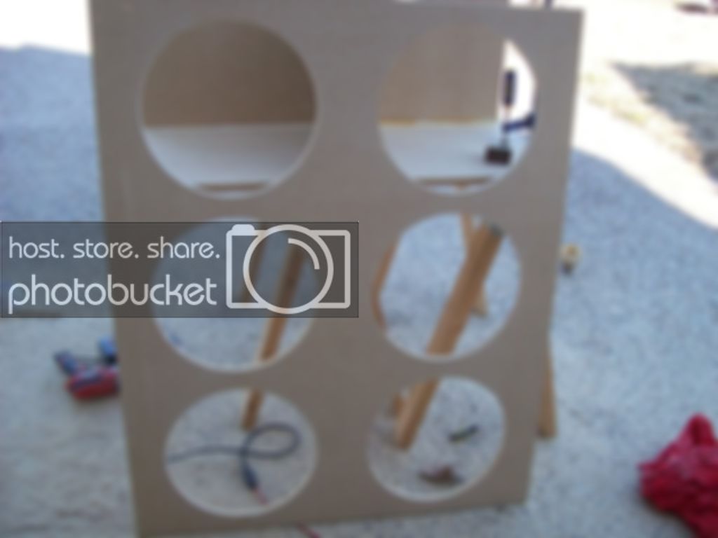

Sealed box for 6 15" CVX's
gsuchyta

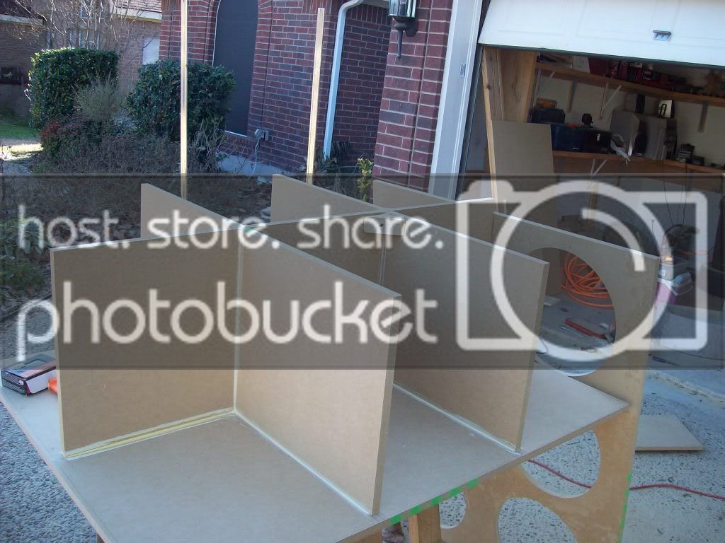

Each chamber is a little over 2.5 cubic feet Going in suburban
I'm sure other 15" subs would sound fine in it too.
Honestly I tried to talk him into ported but he said he had a ported box and likes sealed better. Whether or not he had a good ported box or not is beyond me but I'm sure he will like it and hopefully get loud

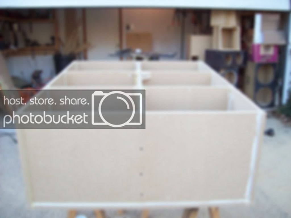

Is it bad to use wood glue when its like 40 degrees out cause it turns white in the not so dense areas? Still dries hard as a rock so I'm almost positive its fine.
only if you are using TB2 or 3 any other wood glue unless it is rated for cold weather will not absorb into the wood and bond. it will look fine but as soon as it warms up it will come apart usually.
