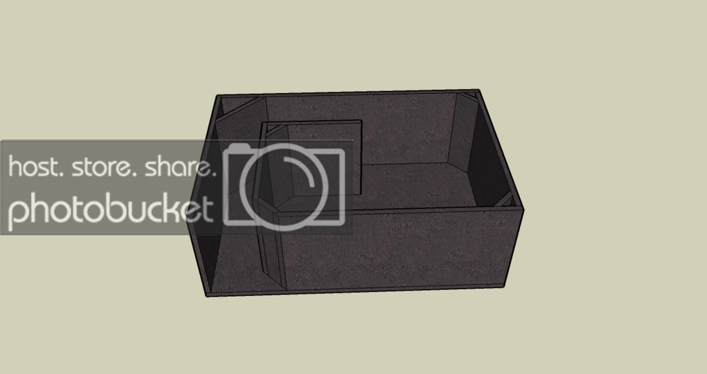

6 cubic feet tuned to 30 hz, 99.75" of port area
front: 31.25" x 14.25"
Left: 26.5" x 14.25"
right: 28" x 14.25"
back: 41" x 14.25"
bottom: 28" x 41.75"
top: 28" x 41.75"
port length one: 17.5" x 14.25"
port length two: 14" x 14.25"
port angle piece: 9-7/8" x 14.25"
the other angle pieces: 4-5/16" x 14.25"
thats my box
for my 88 benz :p
EDIT: it's for a 18" HDC3

I wonder how the lows sound in that box! my old box slammed the lows tunedto 35hz and now that im at 40hz its louder at different freqs and still get low but not as low as it use to..( im in spl for the summer i dont care ill build a box tuned to 32hz for the winter..lol)
