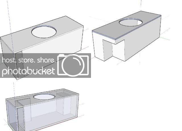

I changed the box up little bit. Its now 4.98 cu ft net @ 32.1hz w/ 64sq in of port. But now it has a nifty spot for my batt //content.invisioncic.com/y282845/emoticons/smile.gif.1ebc41e1811405b213edfc4622c41e27.gif. Im willing to give up some cubes for that. Im thinking it will look pretty clean when its done and it allows the box to sit further from the back.
Still is 48x17.5x17.5, so externally the same as the other design.
Whatchya think?

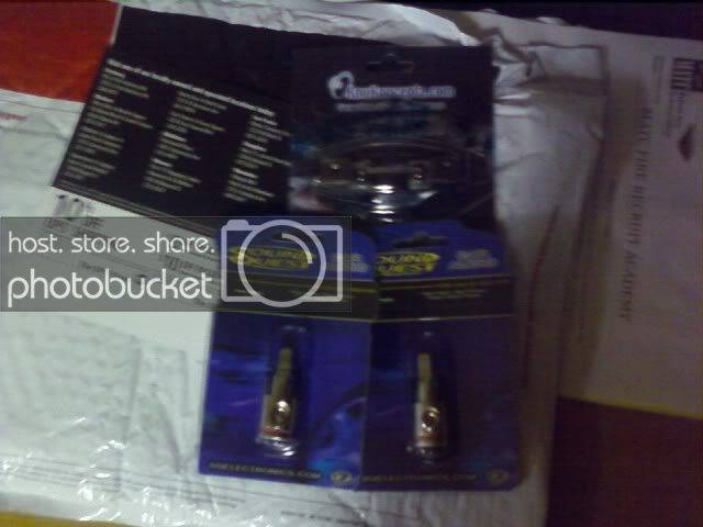

Very small update but its something. Both the men in blue and the men in brown brought something to me today. //content.invisioncic.com/y282845/emoticons/smile.gif.1ebc41e1811405b213edfc4622c41e27.gif
8awg fise holder
2x 1/0awg to 4awg reducers //content.invisioncic.com/y282845/emoticons/smile.gif.1ebc41e1811405b213edfc4622c41e27.gif

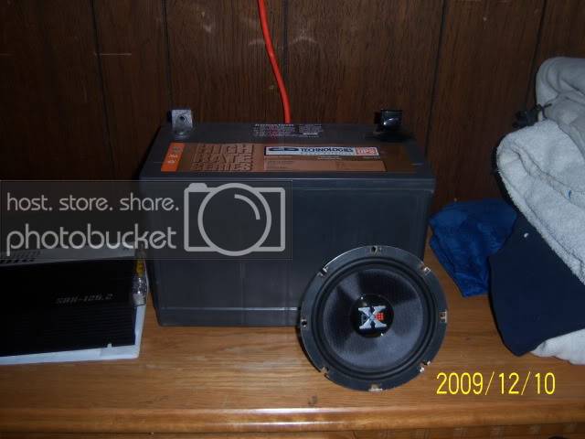

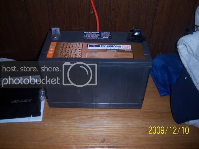

Batt came in. It is a monster! 74lbs of goodness. I thought my batt was heavy but fawk.
Next to a 6.5" mid for a size reference

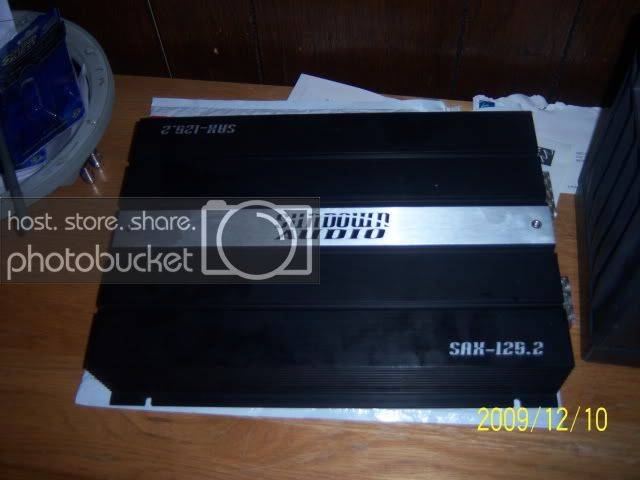

Also my SAX-125.2 came in. I couldnt get rid of my grin when I was opening it. I've wanted a sundown amp for over a year.

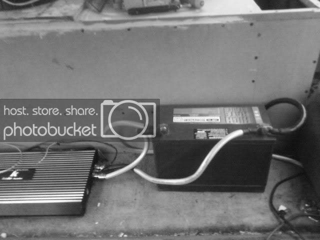

Small update, got my second batt in finally. I think it looks pretty clean. I think I need a new deck though //content.invisioncic.com/y282845/emoticons/frown.gif.a3531fa0534503350665a1e957861287.gif
