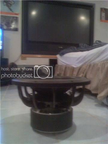

Sub - 15" PSI Cascade Omega D1:
2-2.5k RMS

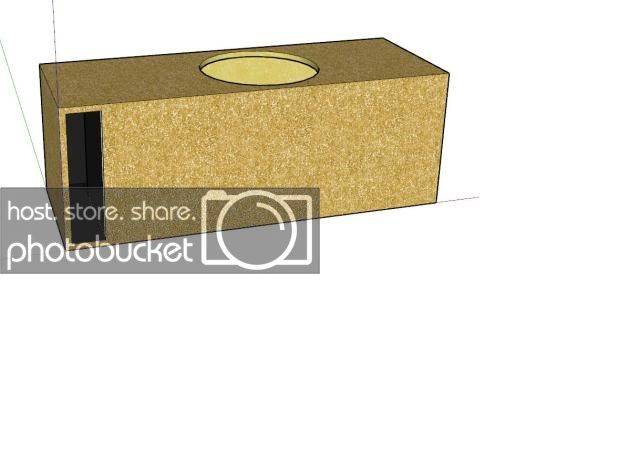

Box:
5.41 after all displacment. Tuning is ~30hz... 30.029hz to be exact. 64 sq in of port area. Should be a fun one for my chopped and screwed music //content.invisioncic.com/y282845/emoticons/smile.gif.1ebc41e1811405b213edfc4622c41e27.gif

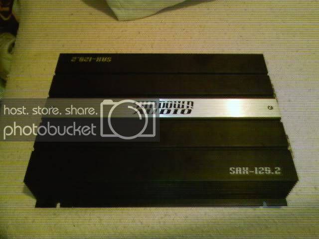

I have ID OEM's, Hi-Vi T20-4 tweeters, and will be running passive on JL VR xovers. For an amp I will be running a Sundown SAX-125.2.
Amp:

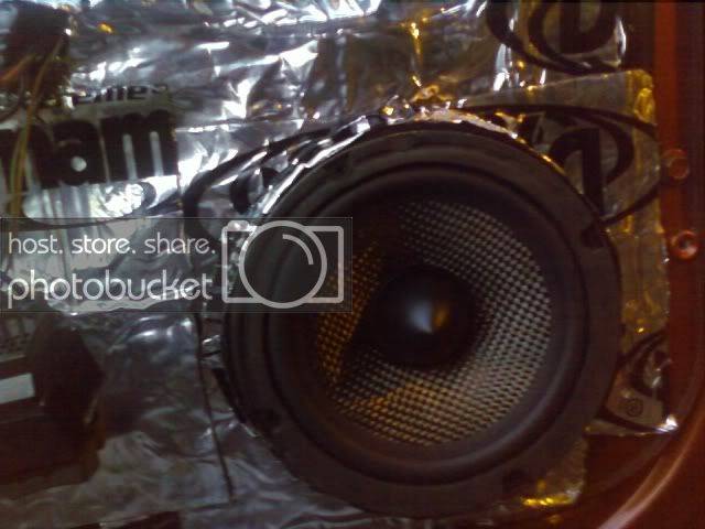

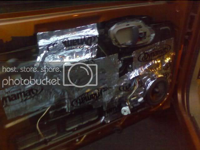

My doors have been done for awhile now but this is what it looks like:

Threw the sub in my 5 cu ft box @ 32hz w/ 111sq in of port (still need to build a new one) off my cheap 2ch amp (mids on 1ch at 2Ω and sub one 2ch at 2Ω) Its temp but the sub already flexs my mirrors and seats //content.invisioncic.com/y282845/emoticons/smile.gif.1ebc41e1811405b213edfc4622c41e27.gif

Who would take such a ugly picture of such a beautiful amp......//content.invisioncic.com/y282845/emoticons/biggrin.gif.d71a5d36fcbab170f2364c9f2e3946cb.gif
Good stuff man, looks like a nice build. I miss my Oems, they should do very well on that Sundown. Have fun. //content.invisioncic.com/y282845/emoticons/smile.gif.1ebc41e1811405b213edfc4622c41e27.gif

once it gets here I will update :p. It looks like the sub amp and frontstage amp will be here at the same time //content.invisioncic.com/y282845/emoticons/smile.gif.1ebc41e1811405b213edfc4622c41e27.gif
that amp will do about 2300 @ .5ohm but not 1 ohm. watch in on the hotter days. had the swiss model, same board and it went poof @ .5ohm on a warmer day //content.invisioncic.com/y282845/emoticons/crying.gif.ec0ebefe590df0251476573bc49e46d8.gif
also watch the speaker terminal outputs as nothing hits them with the slightest of force! they use a 90 degree angle which is extremely delicate and can crack! hence why all new amps use 45 degree angles
oh and the little fan is noisy as ****!

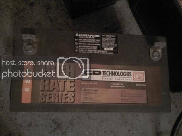

Just worked out a trade deal for one of these //content.invisioncic.com/y282845/emoticons/smile.gif.1ebc41e1811405b213edfc4622c41e27.gif
C&amp;D UPS12-370FR
Volts: 12
Amps: 100Ah
Length: 13.42
Width: 6.8
Height: 9.48
Terminals: TI
Weight: (74)
Manufacturer: C&amp;D
