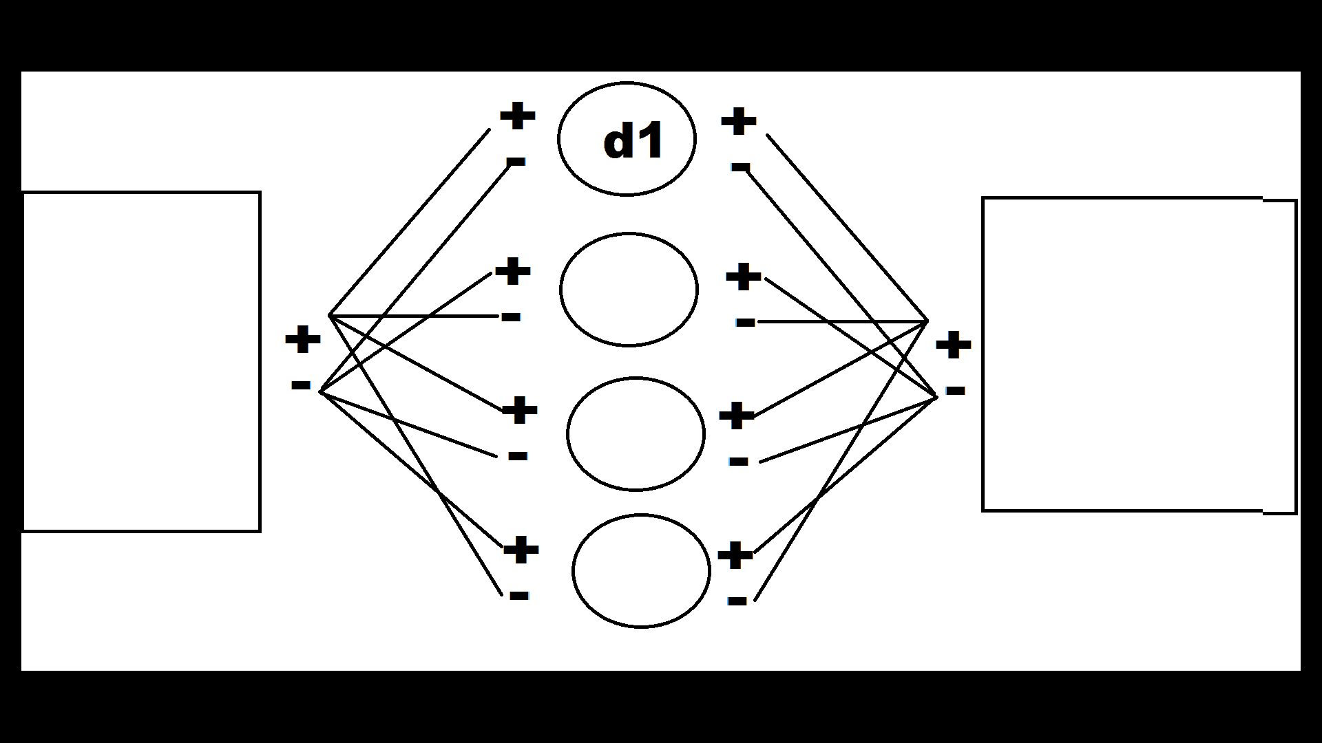

my whole car audio life has been a lie I wonder how many deebeez i've lost over the years. I'm trying to figure out how to do 4 D1 subs in series with this method... pretty sure this wont work but idk.... hopefully he responds to the comments.
From the way the diagram looks in the vid, all the + go with the + on each side and same for -. On your diagram it looks like 2 of them are flipped on each side. Even tho his example is D4 and yours is D1 but the wiring should be the same shouldn’t it? Or were you trying to wire it even lower ohm load?
If i did it the same as he did, i'll be at a quarter ohm load.
