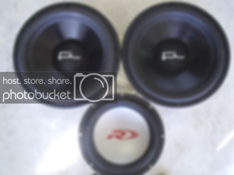

This box is for 2x 15" Fi SSD's i want it to slam. Going to be pushing atleast 800watts to each sub.

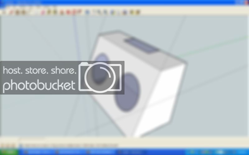

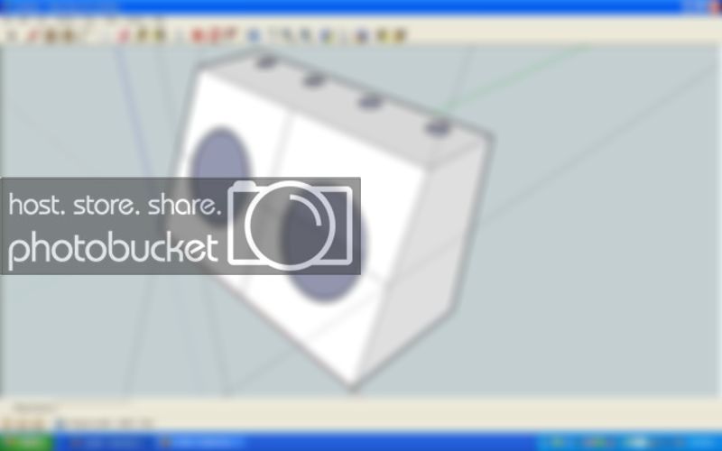

Box is as follows:
9.15 cu ft after sub displacement but before port.
Wedge box 48" wide, 26" tall, 20" bottom depth, 12" top depth.
4x 3" diameter pvc tubing cut to tune to 35 hz. which will be mounted at the top of the box coming to 130 cu inches of port area.
what is this thing going in?
ext. cab colorado truck. What if I did a slot port 19" wide, 6" deep and 9" into the box for 35hz. would that be enuff port area. I dunno how to calculate t i just did length times height came to like 170. Calculator says for these 2 i need 150 ish port area
slot port will do you right and usualy it's 12-16 in sq per cu ft so hats you total cubes?
the box is 9.15 cubes counting the subs displacement but not the port displacement. Fi says 3.5-4 for each ported so i shuld be good even after port displacement
Guess i need a little less port if its 12-16 cuz 170 would be 18. 18"x6" port that goes 8.39" into the box would be 151 sq inches i think? at 35 hz.
tht is still to big you only need 12-16sq in per cube so 9.15 x 16 =54.9 sq in tht box is massive i 'd try 6x 12(72 in sq) using the rear wall as rear of port (to cut down on displacement) adjust length to appropriate freq
9.15 x 16 is like 146
how are you calculating the port length. If i got the right numbers with the port being tuned to 35hz and having a port of 18x6 your port would need to be closer to 17 inches not 8.
