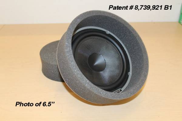

Have you installed FAST Rings?
This is a great way to deal with the issue of sounding bouncing around between the metal of the door and the panel above it. We have plenty of the 6.5" kits in stock.

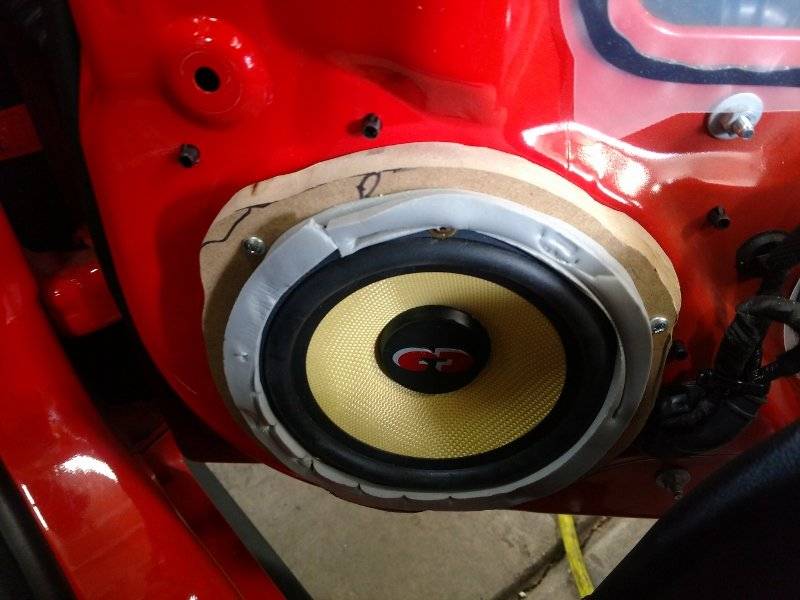

An outstanding 6.5" midbass driver pair I have to recommend is CDT CW-6MB.2. Here it is installed into a 2015 Mustang.
Mounting depth 2.91"
cutout diameter 5.6"
Designed to play down to 50 Hz in doors
sensitivity 87.8 dB
This isn't all I have to show you, but it's the first recommendation.
